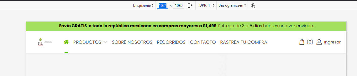

Hello, the problem I have is that my menu bar does not adapt correctly and when closing the screen, the menu items jump out of position.
You can repeat the error, opening the google inspection mode and trying to adapt the page.
I attach images to make it easier to find the problem (See yellow box).
Thank you

Thanks for your query.
Your header columns needs to be resized.
However, you may reduce the font size of your menu items to fit then one line. Here is a sample code snippet you need to use in your custom CSS:
.sp-megamenu-parent>li>a, .sp-megamenu-parent>li>span {
    font-size: 10px;
Note: Path towards custom CSS(Joomla 3): Extensions>Templates>Styles> Click on your current default template name then choose Template Options. Then find custom CSS within the custom code.
Could not understand what to close to see the jumping issue, kindly share an screencast to get it better.

Hello.
Thanks for the help, however, my problem has not been solved.
I have added a gif where I show how to reproduce the error.
As you can see, when I use the adaptive mode at any pixel size the menu jumps out of line, regardless of the font size.
I hope that with the gif it is clearer to you what is happening.
With the mouse pointer he tried to point to the problem area.

The most easy way is to change the header column grid from: 1+7+4 to 1+9+2 in Template Options - Layout
Don't worry, I will set it
done, should be much better
