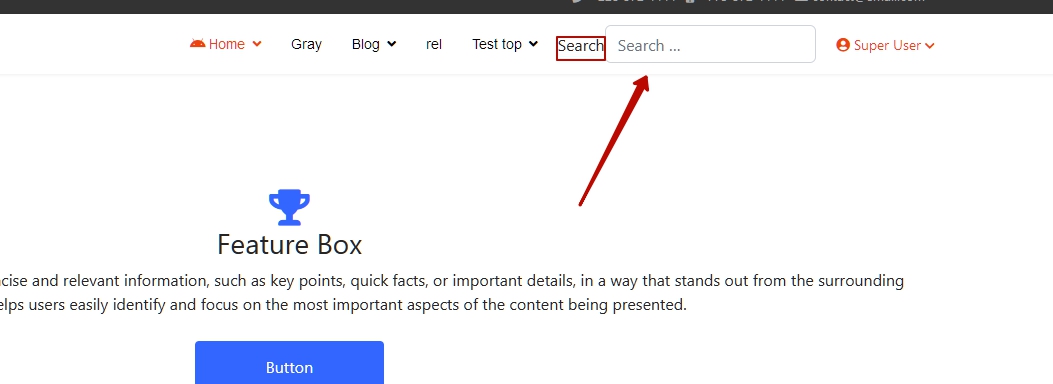

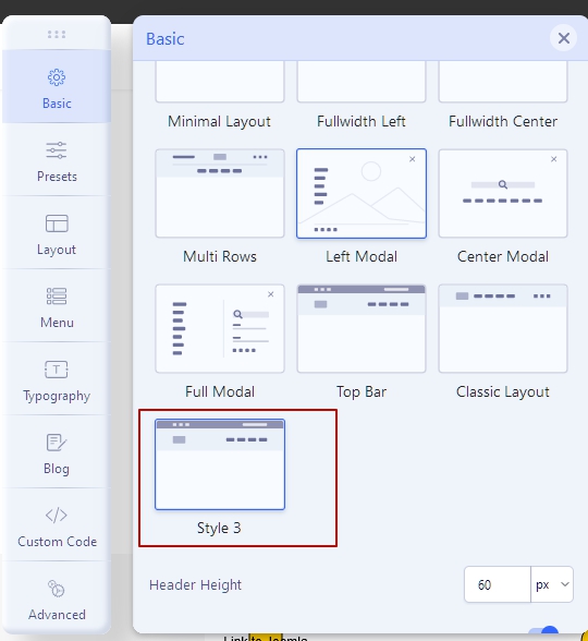

Here is example using option 2:
  1. Create new folder with unique name inside headers folder (in my case it is style-3 folder).
  2. Copy files from existing folder to the new folder (in my case I copied files from style-1 to style-3).
  3. Open header.php from style-3 folder and edit it by replacing from this line...
    php echo ModuleHelper::renderModule($searchModule, ['style' => 'sp_xhtml']);
    ...to that(this creates the module position with search-header name instead of the default search module).
    jdoc:include type="modules" name="search-header" style="none"
(You should add open/close corner brackets like in a screenshot since I can't add the code with them to the post.)
And save.
After these actions, you will receive your new Header style. Choose it in the settings.
  1. Create new search module with filter you want and publish it in search-header position, just by typing position name and press Enter.
You will get it.
  1. And all that remains is to hide the label through CSS.
