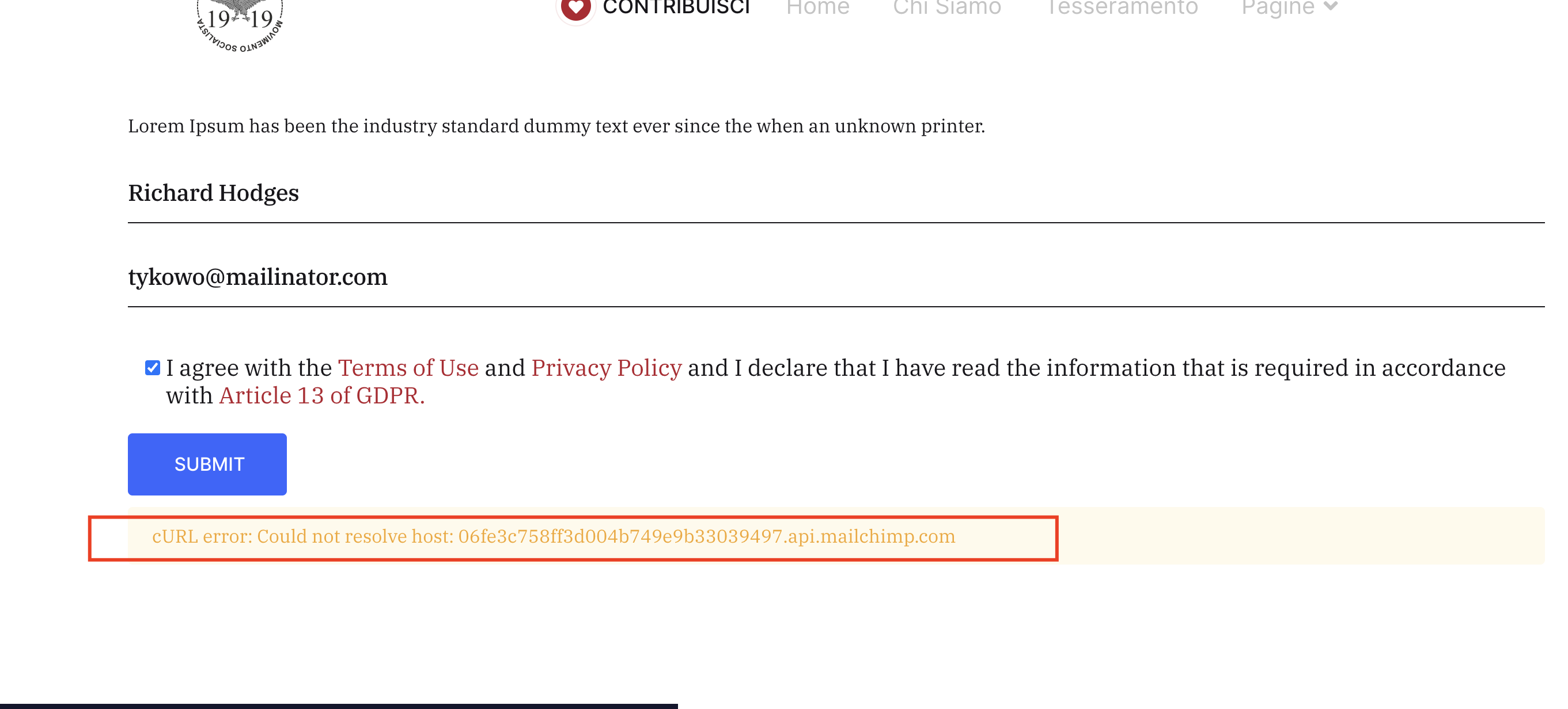

Senior Staff 2 years ago #143398
Please share this screenshot with your to your hosting provider.
