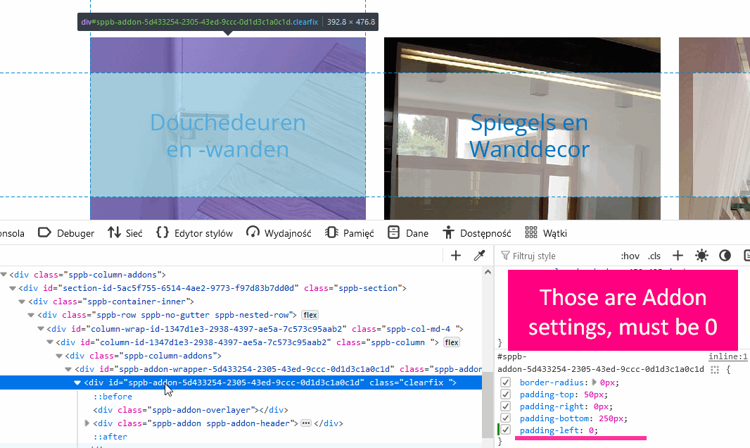

At this moment the blocks a big and a the left and right side nog the same.

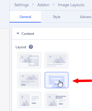

Yes, there is alternative... Image Layouts and maybe that style
To correct left area - just remove left padding, now you have 20px, set 0px - for each 3 addons!
