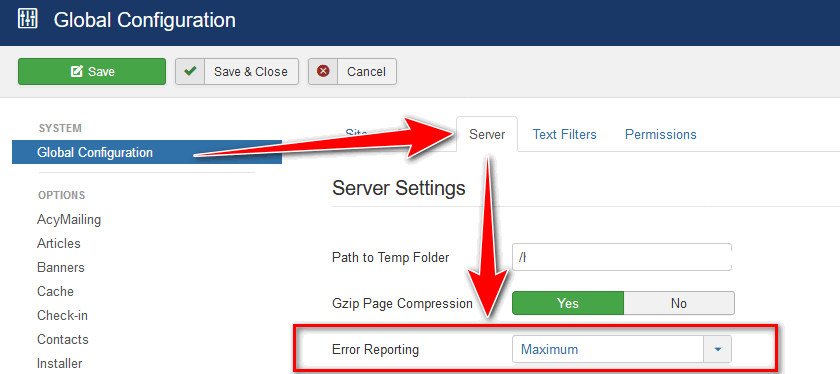

What PHP 8 exactly? With PHP 8.0.x should work ( I use all the time), but with PHP 8.1 may not yet.
Sometimes problems are caused by extra plugin or module not SPPB itself.
To see more than white page, I mean error message that can you solve the problem please enable this mode
