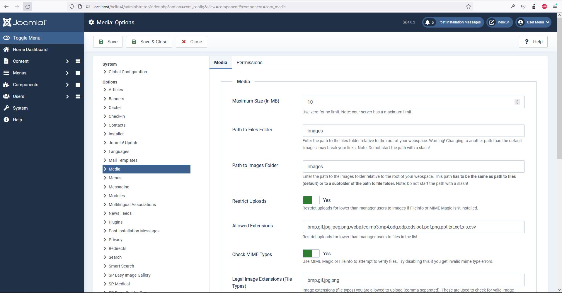

I'm using the latest version of SP Page Builder and Joomla 4 and I'm encountering a similar issue that others are having – getting the 'COM_SPPAGEBUILDER_MEDIA_MANAGER_MEDIA_TOTAL_SIZE_EXCEEDS' message when trying to upload through the Pagebuilder. I've contacted my webhost 1&1 / Ionos and they changed the memory limit to 512M and even 768M, neither of which helped. I'm able to updload through the Joomla media manager and FTP, but it would be nice to be able to upload directly through Pagebuilder. Is there anything else I can try?

Thank you for your query. Have you tried the following?
You can go to Global Configuration -> Media and then set the value in Maximum Size (in MB) field.
Joe Rupp Asked this
I did. It's set to 10MB. The only thing Ionos changed was adding a PHP.INI file with "memory_limit = 512M;" in it. Does that seem like it was done correctly?
