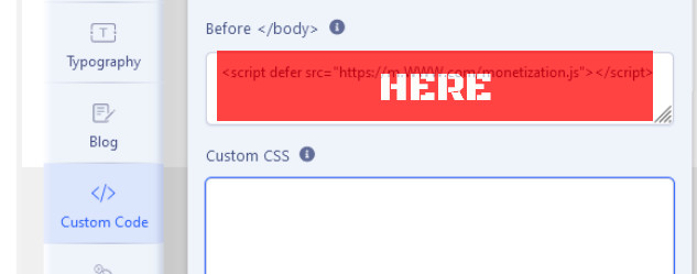

We tried to add it at "Template Options"-->"Custom Code"-->"Before Body"

Senior Staff 4 years ago #59225
yes, use your custom code in Template Options - Custom Code - Before < / body >
it's the best place for this kind of code which should be loaded as last one.
