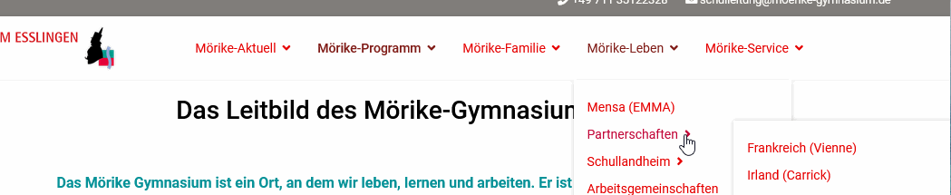

Dear all, I've got a problem with my menus when using the Boxed Layout. They are being cut. https://1drv.ms/u/s!ApP852Q0XLwohMEPa8gA9Pb-nKhMBA?e=3GlIQj Do you have any idea how to fix this problem?

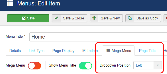

If I may... you have to change "Dropdown Position" from default value to left, it should help a little bit. But MegaMenu must be enabled.

Hi Paul, I tried your css-code and you can see the results in these two pictures:
  1. https://1drv.ms/u/s!ApP852Q0XLwohMER5tQgMPbTTp27Aw?e=iwDKTF4
  2. https://1drv.ms/u/s!ApP852Q0XLwohMESKkPcw6HgYspW8g?e=oEBL5c
Unfortunately the problem with the Boxed Layout is that all the menu-part, that is out of the box is being cut. If you've a short article in the component position and therefore a minimal height of the boy (see pictures), also the vertical menu isn't displayed completely. At least there's a scrollbar, that appears.
So either I've to reduce my menu items or change to some kind of MegaMenu. Or find a solution without the functionality of the Boxed-Layout. The startpage doesn't use it.
But thank you for your support Felix
Senior Staff 5 years ago #5520
Yes, Unfortunately Boxed-Layout in current version of HU has it's own limitations.
As I saw was better, but not perfect. That's why I still recommend to NOT use very deep menu structure, max 2 levels.
