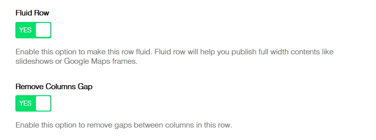

In Row Options > Fluid Row: Yes and remove gaps: Yes

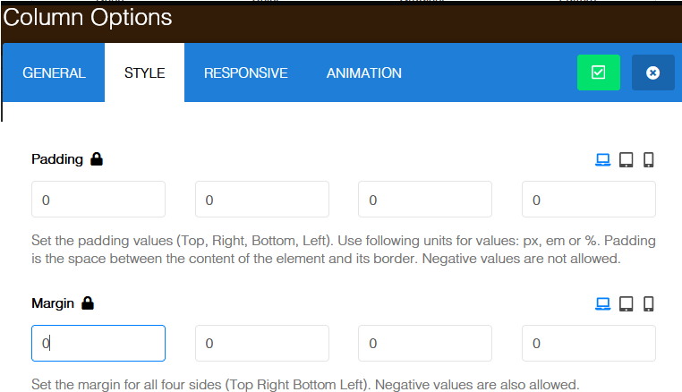

Then in Column options (inside that Row) remove all padding values, set 0
It should help.

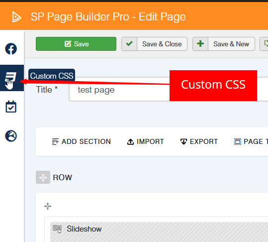

And above custom CSS you can add inside that Page > Custom CSS
