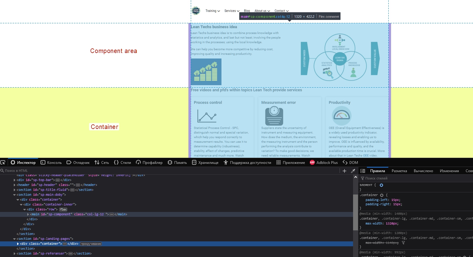

I see that the container width of the Component area is different from the other sections of my webpage (wider): https://arbeid4.joomla4.no/ Do you know why?
Can you help me get the same container width for the Component area as the other sections?
I also notice that there is no padding around the component area. This does not look good, specially on mobile; the text is difficult to read without any padding from the screen edge.

Thank you for your query, could you kindly provide a screenshot please? That would be helpful for a better understanding.
Sissel Lundeby Asked this
See: https://arbeid4.joomla4.no/images/Wider_component_area.png
I asked for help previously because the component area was fluid and someone at your team added the following css code to my template:
@media (min-width: 992px){
body.view-article.remove-container .body-innerwrapper>#sp-main-body>.container, body.view-article.remove-container .body-innerwrapper>.sp-main-body>.container {
max-width: 960px;
@media (min-width: 1200px){
max-width: 1140px;
@media (min-width: 1400px){
max-width: 1320px;
Can the code be adjusted so the width of the component area is the same as the rest of the page?
(the issue with the padding is solved using css code).
Sissel
Hi. As can I see it's the same.
Great!
That code solved it.
Thank you,
Sissel
