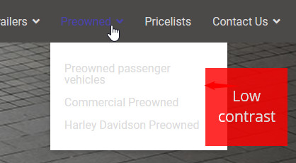

  1. What accessibility tester you are using?
  2. About Iframe warning they are from Video addon where you used youtube clip? If yes, we will fix it in one of upcoming udpates. Or you can use iframe code directly from YouTube if you don't want to manually edit video addon code.
  3. Please correct color contrast in submenu, now is too low, it also very bad for accessibility! Even for heathy users is almost not visible.
GarageCentraal Asked this
I started using the tester in the Hyundai corporate testing site, and then rechecked it using Lighthouse on Chrome for mobile.
The color in submenu is far darker, and it still renders that light! Please check that for me...
