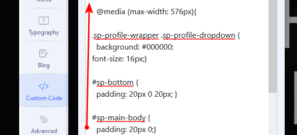

I want to reduce the amount of padding at the top of the main body from 100px to 20px and added this code to the custom code of the template parameters but it is not changing it...
sp-main-body {
padding: 20px 0;
I have added this same code to a few other sites I built using the Helix template to reduce that same padding and they are fine. Can you assist?

Hi Jay,
indeed that CSS code
#sp-main-body {
  padding: 20px 0;
is fully correct, but inside your Custom CSS you used it only for Mobile view @media (max-width: 576px){ ... }
and then work!
If you want to use it on all views, use that line above @media...
