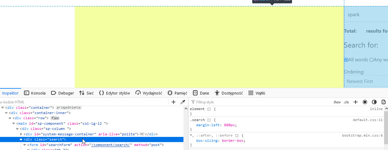

The Joomla search results page displays to the far right of the page. The search results page should show (was showing) in the main content area and now it's on the right. This is not in a module position. I tested the search in Joomla Protostar and it displays fine.

Hi Shirley,
Ok, I see... It looks that somebody from your "team" added & used that
.search {
  margin-left: 880px;
to extra default.css file.
yes, small mistake! Easy correct 4 you.

Thank you, however, I placed the margin code in there to position the search bar in the top position to the right of the page, otherwise it displays behind the logo like this:
https://screenrec.com/share/9zanNC63RU
How to position the search bar where I need it in the upper right and still have the search results come up normally?

Sorry, but joomshaper support is not here to teach CSS and SEO. Support Policy rules.
If you really have to use left-margin but for
#sp-search { }
not.search {} as you did.
But I would use different style than margin.
