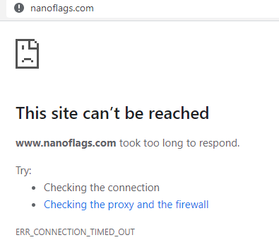

Michael Koerner Asked this
Go to the link I provided and you'll notice the issue where I indicated it was.
If I may...
Link doesn't work - site is not loaded, I tried few times, also using VPN.
So please help us (and yourself) and:

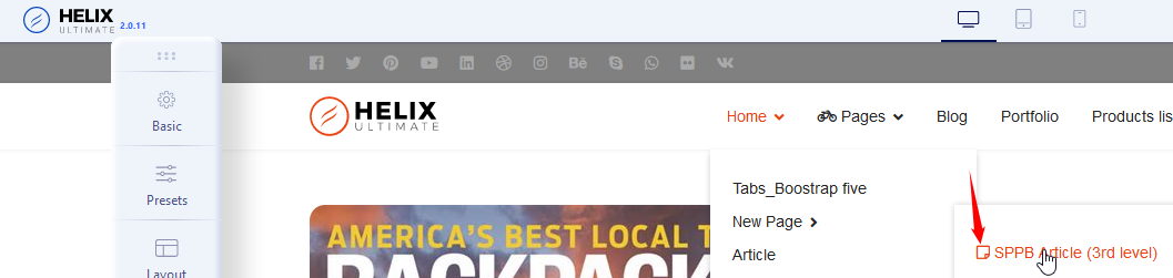

I also made test using Helix Ultimate 2.0.11 and FA icon was also displayed in 3rd level of menu, screenshot

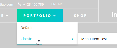

Okay I think I have uploaded the photo sucessfully.
Paul:
Thank you so much for this information, it fixed my problem completely!
