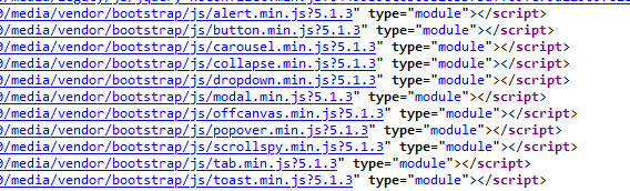

They apearded after latest framework update. Before i used jch to block all unnecesary files.
Could you please explain what are these files for?

if we talk about Joomla 4, those files are loaded from here (joomla core)
I have to talk with our developer to cut them off in next Helix update, probably in bootstrap 5.x there is sort of "call / request" for them by default.
From that file: media\vendor\joomla.asset.json
But I don't know the relation with Helix Bootstrap 5 itself ;/
Did you know that Joomla 4.2.8 have built-in Bootstrap version 5.1.3, and Helix Ultimate uses Bootstrap updated to the latest version v5.2.2.

Paul thanks. Are not all these files loaded from template? If i install older template these files are not loaded.
  1. No, as you saw - from Joomla core folders. BT is built-in inside Joomla 4.x engine.
  2. Check on your site (or demo/test site) to be sure.
