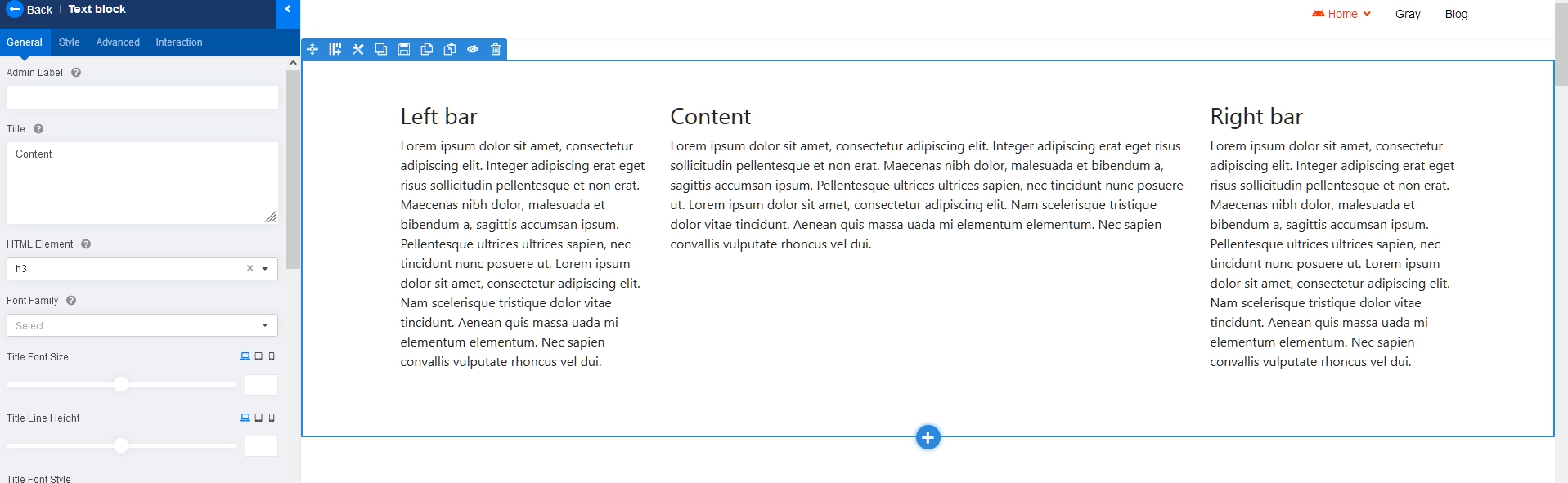

On this page, the correct behavior of the layout https://rctest.piningforthefjords.co.uk/catalogue/search-starfield?f=5
On this page is not the correct behavior of the layout https://rctest.piningforthefjords.co.uk/owners/why-mrc
On SP pages (not SP article pages), it should not to use the left/ right position of the template. The layout must be created by SPPB means but not by template.
Use one global SP section for global page layout and inner sections in content part

Just know that on SP pages you can not use Left/ Right positions if Helix is used. It breaks the layout. I would not call it a bug, but this is some inconsistency between Helix and SPPB. You should create layout via section settings. If you need full width, turn ON fluid row option in section settings.
