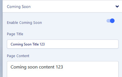

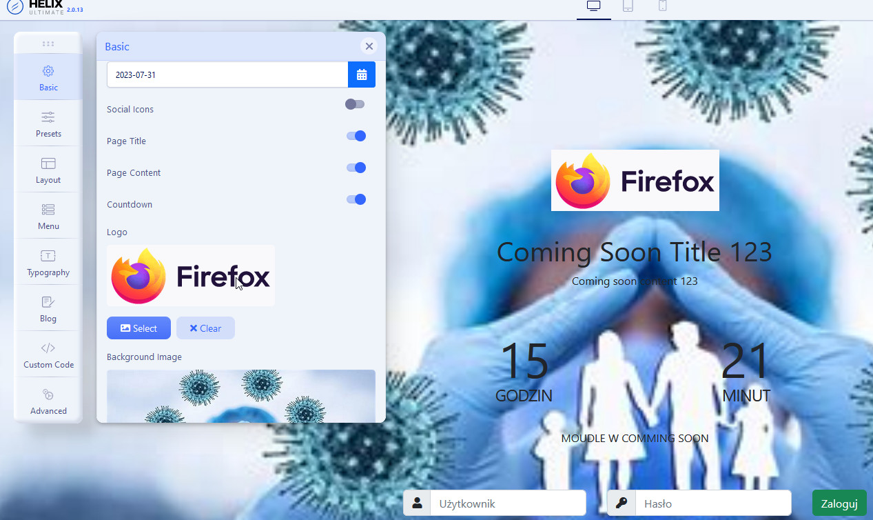

  1. Anytime you can delete offline.php file from template folder and then Joomla would use default file from Joomla core.
  2. But indeed small correction (rename) in Helix code is needed, but right now in raw Helix Ultimate 2.0.13 you can customize that text using: Helix Options > Basic > Coming Soon. Just add your text and image there and then disable (off) Coming Soon after. info_1258_2023.jpg
this text & img will remain on Offline mode page - when is enabled.
