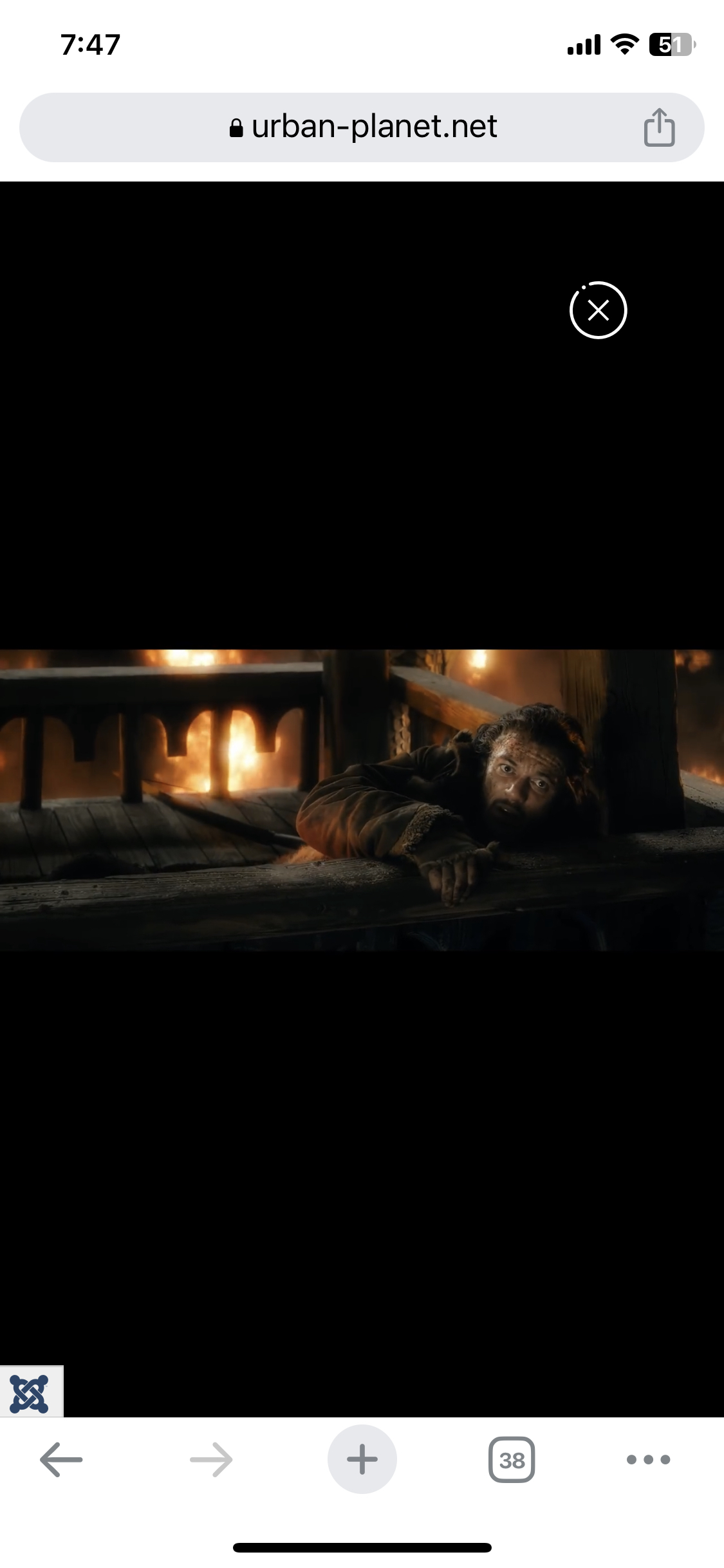

  6. On mobile view, the pop up isn't responsive at all. it get cut from the top.
It works fine
