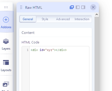

Hi.

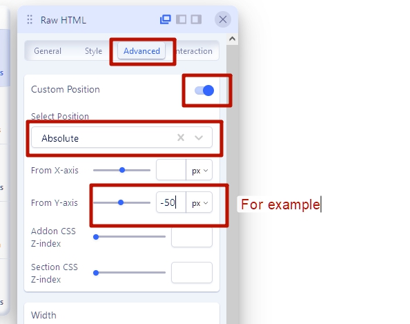

Add Raw HTML addon where you need with the code like <div id="xyz"></div>. Delete all margins values from Style tab, use Advanced tab > Custom Position to fine tune anchor (aka addon) vertical position
Keep in mind that the anchor is tied to the left upper edge of the browser. Therefore, if you have a fixed header, you must compensate for its height using the negative value of the anchor Y axis position.
