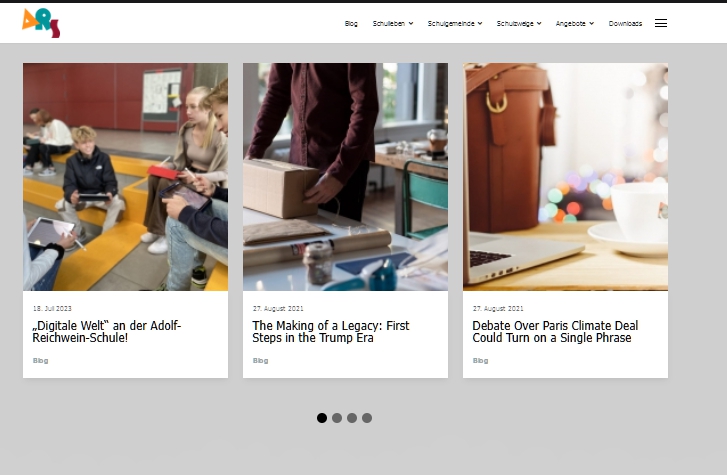

the Article Scroller on my home page looks terrible!
Link: http://joomla.ars-langen.de
Is it possible to change it?
I would like to adjust the following items:
  1. the width of the images should be based on the boxes.
  2. all boxes should be the same height.
  3. the lines for pagination in the upper right corner, I would like to replace with dots, which are below the boxes.
With best regards
Andreas

Andreas Wolf Asked this
I already have posted a link and a screenshot!
There is no screenshot here. Could you please send the screenshot again?
Hi Andreas. It can be done only via css.
Here is starting point code. But you will need more coding to make it responsive.
Thank you very much for your help.
The customization of the addon seems very cumbersome. Unfortunately, nothing is written about it in the documentation either.
