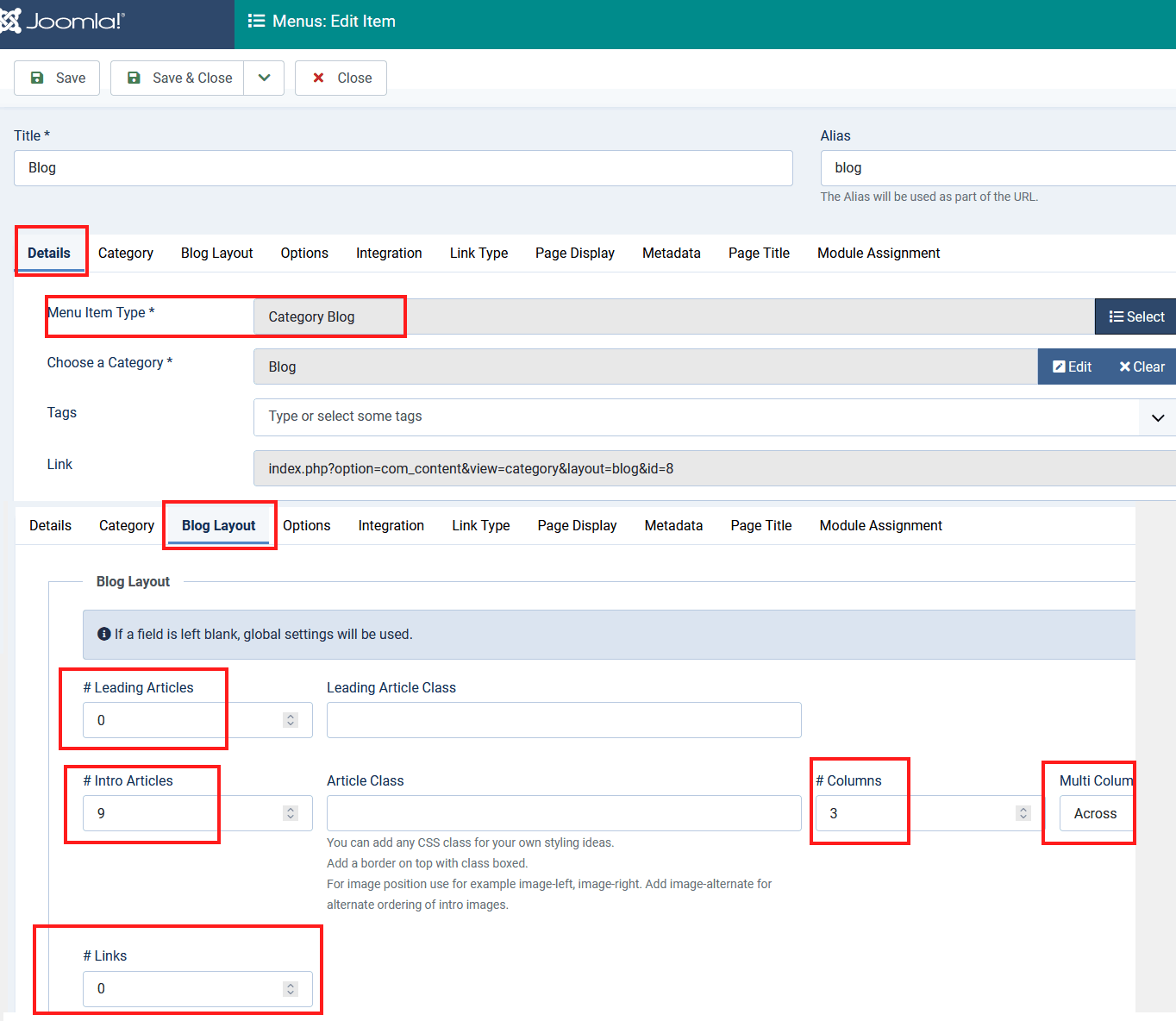

ad 3) you have to use menu item > Category Blog view with 3 columns + serveral lines of custom CSS and then it should be possible, but as you see as component view, not module nor addon view.
The above method has another advantage, created short alias by Joomla Menu for each article link. But I think that's obvious.
