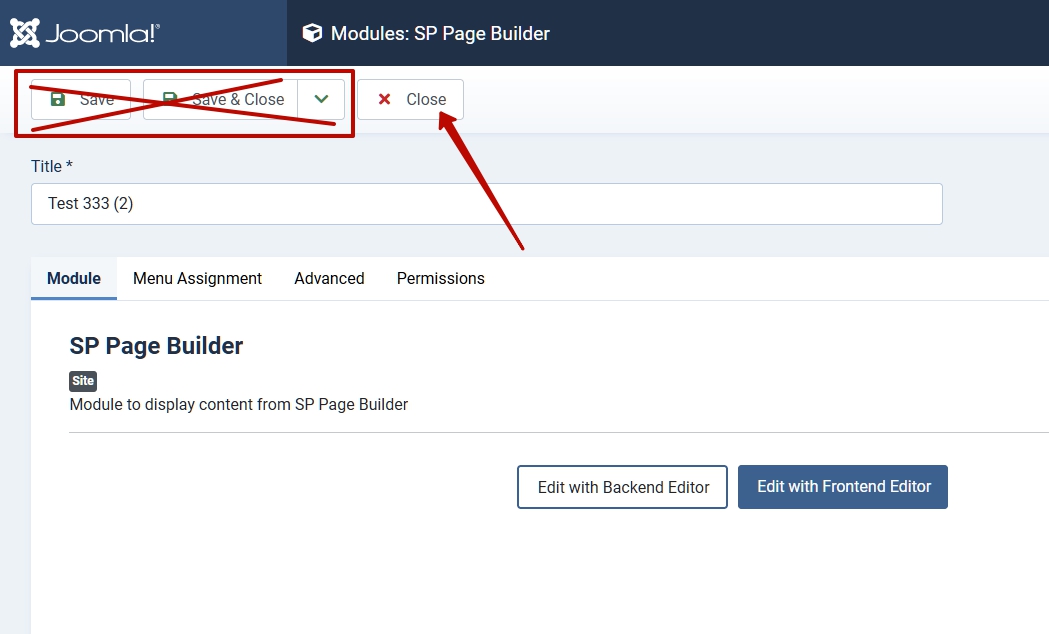

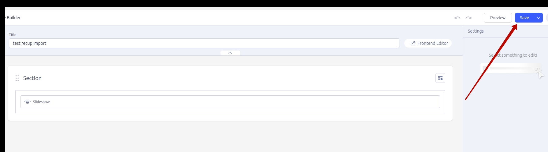

Hi. Use this button to save
But do not press save module button on this screen after making import. Jast close
3 years ago #127273
Hi. Judging by this, you did not open the module again, but created a copy of the module and opened it.
When creating a copy of the SPPB module, the contents are not preserved (due to the technical features). You need to make export of the contents from the original module, and then imort in a copy of the module.

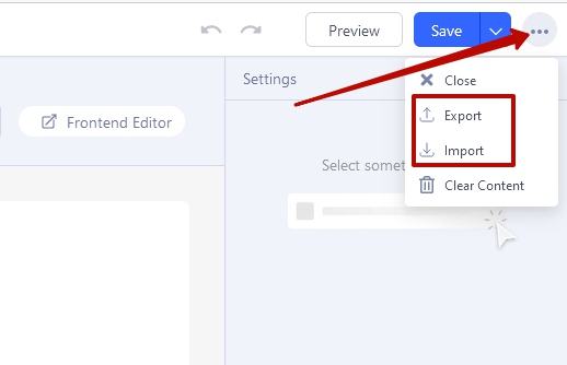

Support Agent 3 years ago #127945
If you want to duplicate a module, then follow the steps.
  1. Open the SPPB module in backend or frontend editor.
  2. Export the module.
  3. Take a new module.
  4. Import the JSON file.
  5. Then modify it and save it with a new name.
