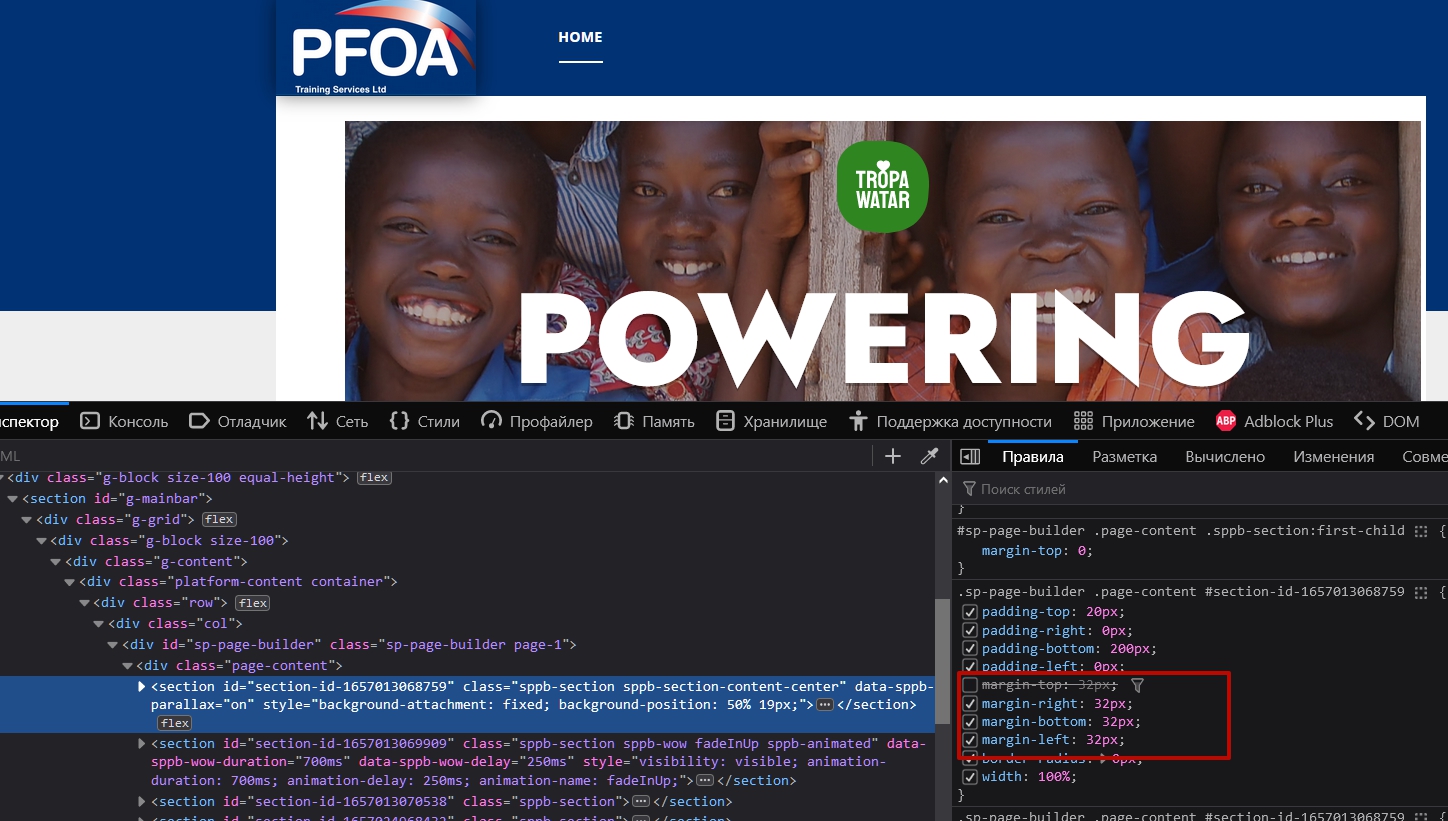

Having tried to set this up with some demo content i find that it fits really well down the right side but not the left and the top, as you can see there is a fairly large gap which i cant figure out how to fill. I approached RT about this and they suggest the following:
"It's not that it's not fitting within the Theme frame, it's not fitting within it's own frame. See attached. I have the main SP wrapper (.platform-content container is identical) highlighted in the Inspector and you can see the visual highlighting above (blue overlay)... you'll see the content spilling out the rightside of that. Unsure if that's intentional design or a conflict, but the Theme/Gantry is properly framing the rendered content."

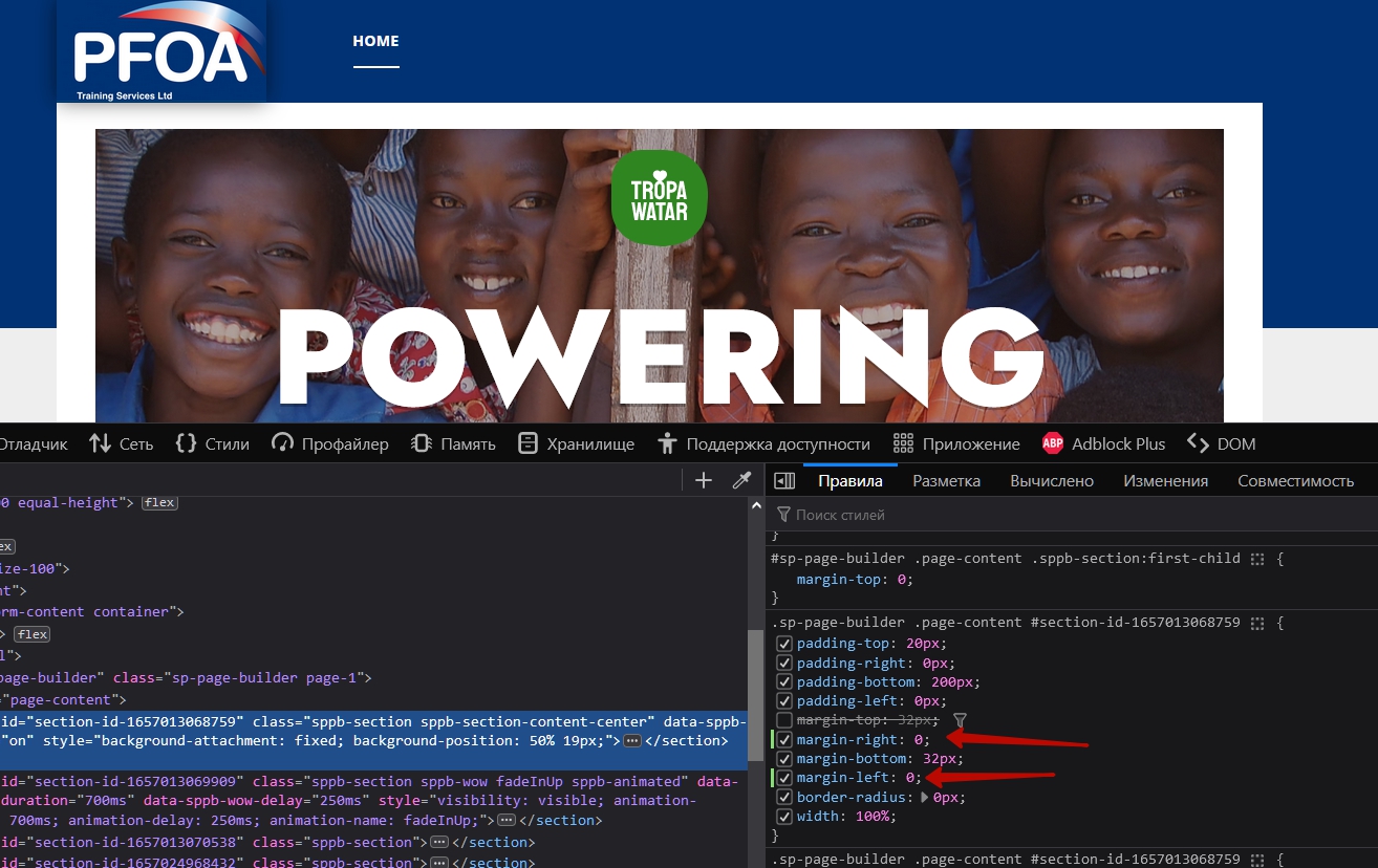

Hi. The reason is the margin settings in your SPPB section.
If you set left and right margins to 0 it will look ok
If you want this appearance...

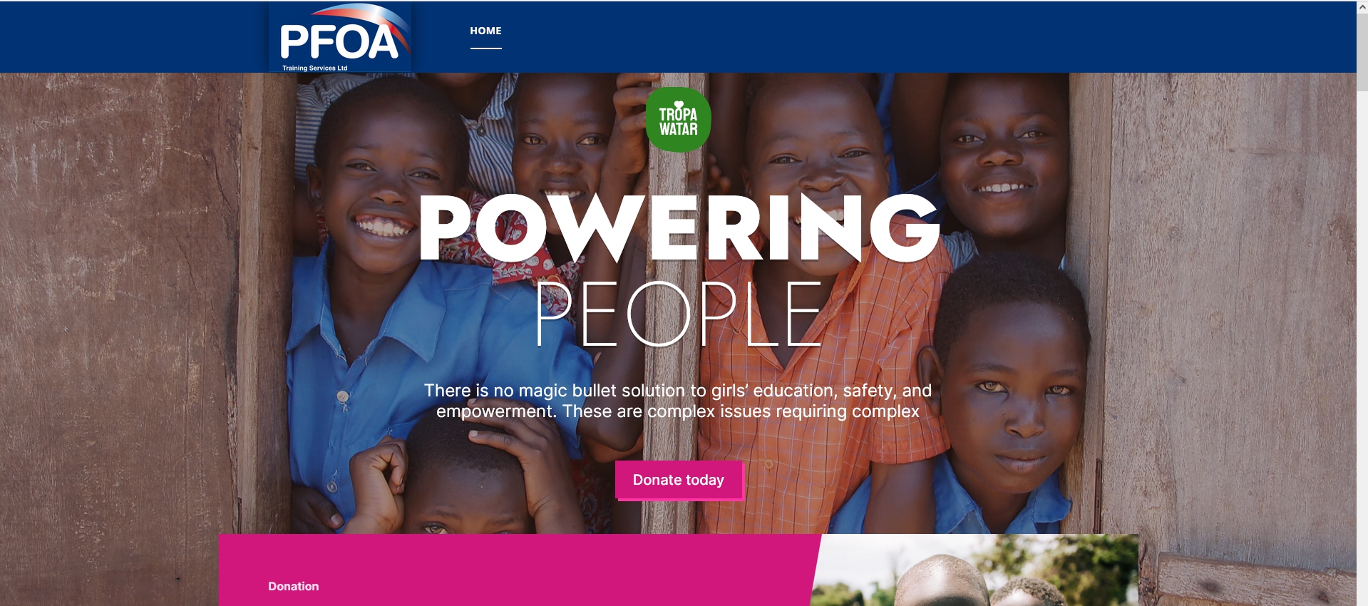

If you want full width appearance...
... CSS will be:
.com_sppagebuilder.view-page #g-navigation + .g-container {
    width: 100%;
.com_sppagebuilder.view-page #g-navigation + .g-container > .g-wrapper {
    margin-inline: 0;
.com_sppagebuilder.view-page :is(.g-content, .platform-content.container) {
    margin: 0;
    padding: 0;
And perhaps some other CSS code for fine tuning will be required.
