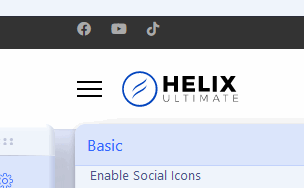

Hi Rafael,
show me (screenshot link) how you use it. Now I see there only 3 icons.
If we talk about Helix Options > Social Icons > Custom > the correct code should be:
fab fa-tiktok URL
is now all clear?

I cannot make you php code customizations. It's beyond support.
But you can:
  1. use current social icons then just replace used icons from current to needed one by custom CSS.
  2. Or, disable social icons from Template settings, and publish in position SPPB module with icons.
  3. Or, you can also use Custom module with html and Font Awesome Free 5.15 icons code inside, this is also very simple and flexible solution.
EXTRA tip
I saw that you already used tiktok at the bottom, but you made mistake, use that custom CSS to fix it
.fab.fa-tiktok {font-family: "Font Awesome 5 Brands"; }
