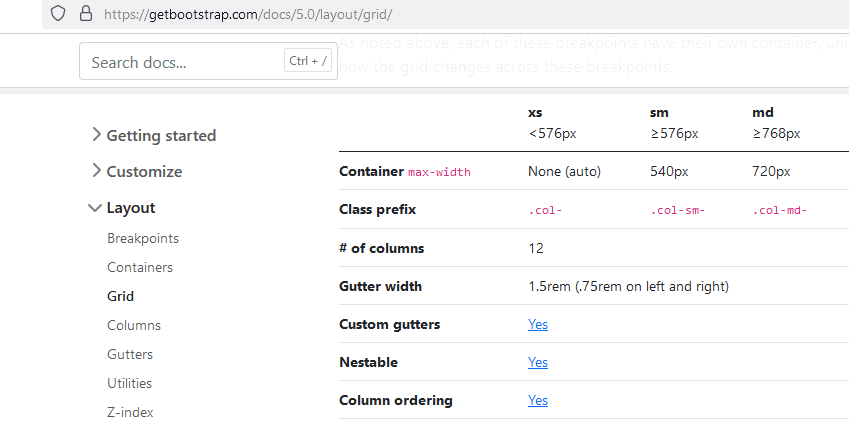

Offcial Bootstrap 5 Grid options
and we have ≥768px in CSS BT5 guides:
// Medium devices (tablets, 768px and up)
@media (min-width: 768px) { ... }

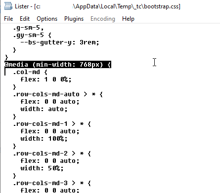

also in current BT 5.3 it looks that same. Inside all versions of BT 5.x (file bootstrap.css) the real used breakpoints code is:
also inside sppagebuilder.css (SPPB 5) we used:
@media (min-width: 768px) { ....
But it's from Bootstrap 5.3 (not used yet by us) and it's used for tables and offcanvas.

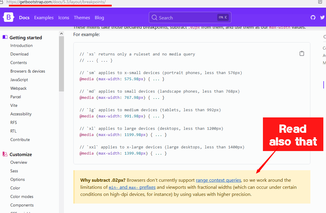

I keep insisting that you are using Bootstrap 3 breakpoints (I'm just talking about the breakpoints)
It can't be bootstrap 5 because this one has 5 breakpoints and yours has 3.
You also say that in BT5 sm is from 576px or more and that your sm is 768px, therefore it is within the bootstrap guide. Which is a lie because you forget to say that in BT5 the max-width for sm is 767.98px and 768px is already md. This still leaves your sppb-col-sm on BT3.

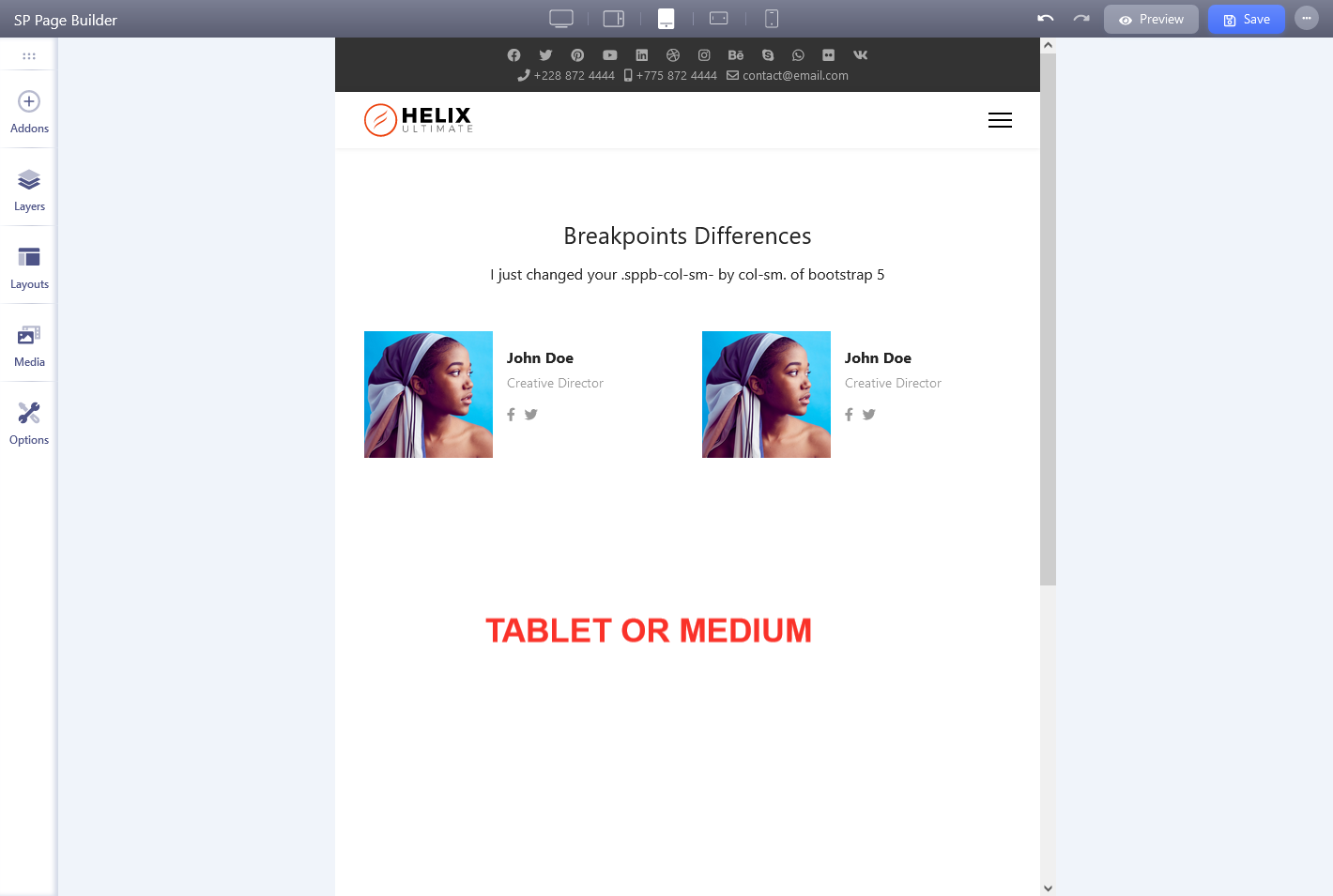

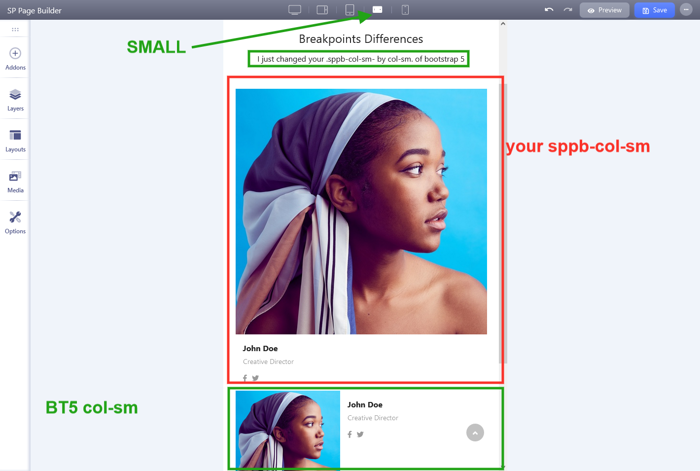

Demonstrating with examples:
The images demonstrate that the sppb-col- classes do not use bootstrap 5 breakpoints.
So why does sppagebuilder.css have different breakpoints than Helix, or the same SPPB5 Edtior, which has 5 breakpoints that coincide with bootstrap 5 and that are used to control the columns in the sections?
