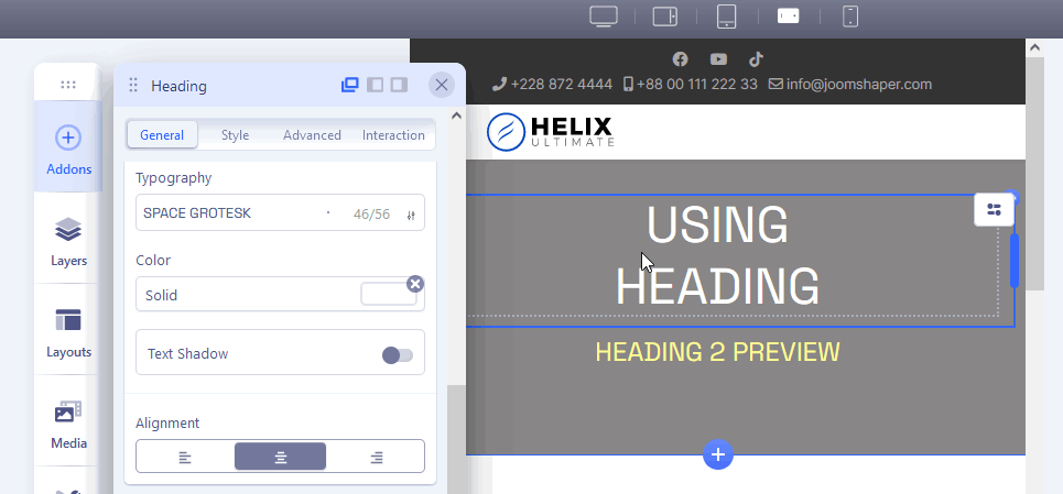

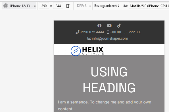

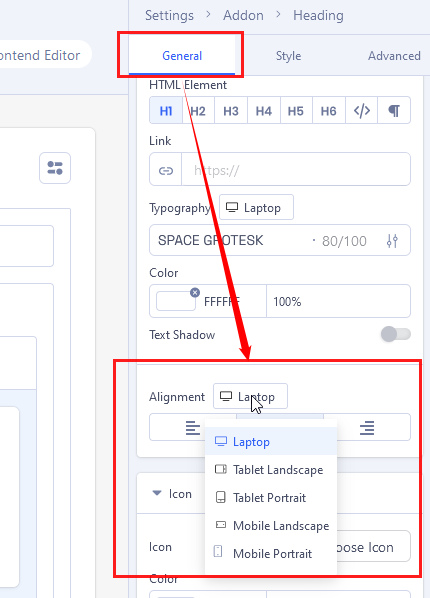

Can you check settings again by this time using back-end editor
on my demo site is working OK - text is centered on Tablet and Mobile view is I set that using above option (back-end).
Now I will check front-end editor....
also seems to be OK
Maybe you had enabled Production mode in SPPB 5.0.9?
Sorry, but I couldn't reproduce that problem also using front-end editor, watch YT clip
