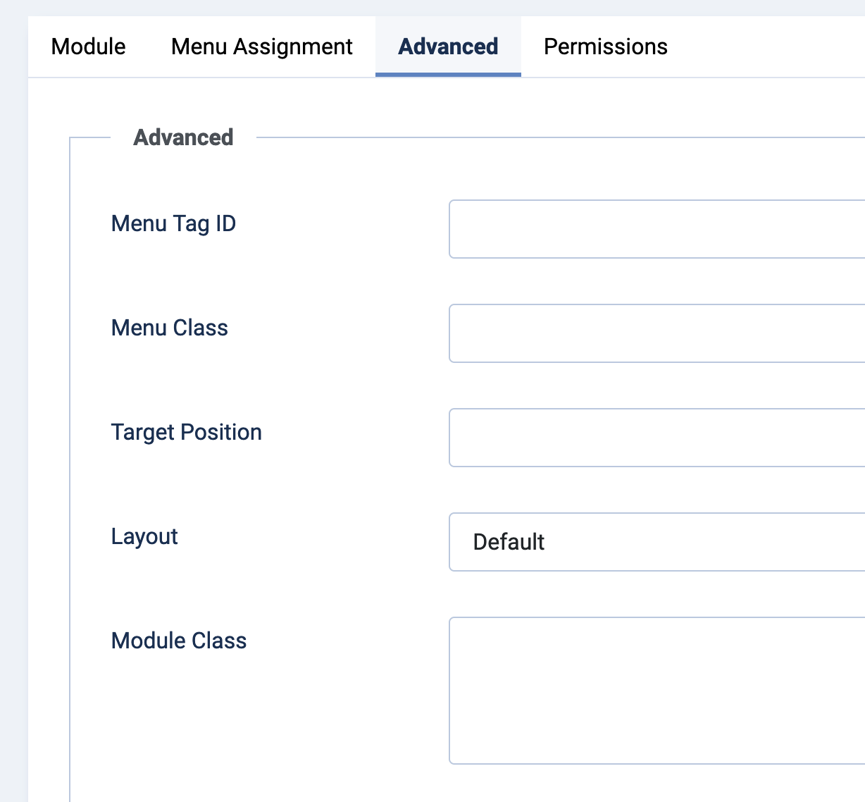

  1. Have you published a Menu module in "offcanvas" position? If not, do it.
  2. If yes, Compare Menu module settings with recommeded and correct if you have different one. Remove all extra class names and Layout: Default.

Yes, the module was published, and the menu worked fine, at least until v2.0.14. I didn't notice until the patch to 2.0.15 (since the site also uses a mega menu.) Unpublishing the module fixed the menu. But in checking the settings, the Layout had been set to "Collapsible Default Menu." Switched that to "Default" and re-published the module. Menu working fine now.
