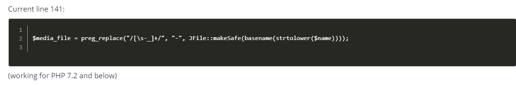

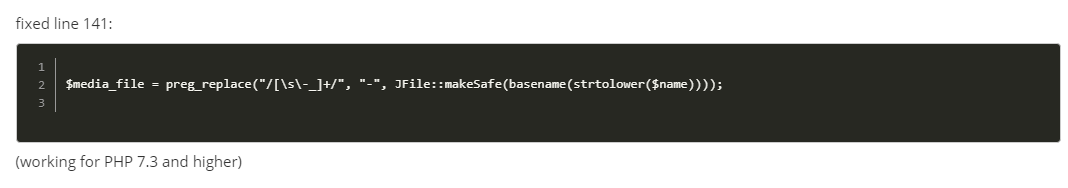

Can you please try this solution? The issue might be because of Bug is in public_html/administrator/components/com_splms/models/lesson.php in line 141.
In the newest version of PHP the hyphen now needs to be escaped (in preg_replace). php.PNG
