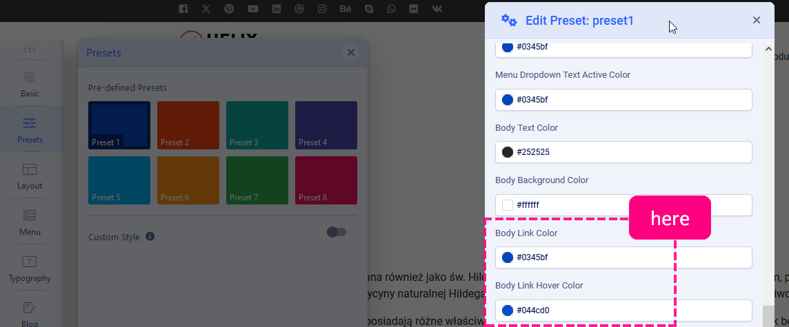

Hi Philip,
I understand, but can you check what what color you have set here?
of course choose your current set Preset, I assume it's a blue variant. Click pen icon to open that window.
Without access, it's like being a chat doctor.
Philip Asked this
It's set on custom style, not any of the default presets. That's why it puzzles me.

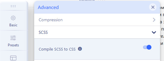

Done, fixed.
I only used that
Philip Asked this
Perfect, thank you very much! But what was the root cause?
Because, having SCSS compiled is not exactly what I read as recommendation in the documentation:
https://www.joomshaper.com/documentation/helix-framework/helix-ultimate-2/advanced
...Compile SCSS to CSS - enable this option will compress all SCSS files during each load of your website if the SCSS file has been changed or edited. Turn off this option if your site is in production mode.
