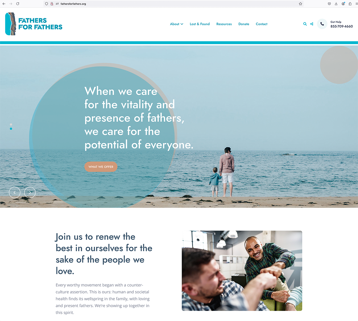

Also, below is the screenshot of the site using just http://
http://fathersforfathers.org/images/Screenshot1.png

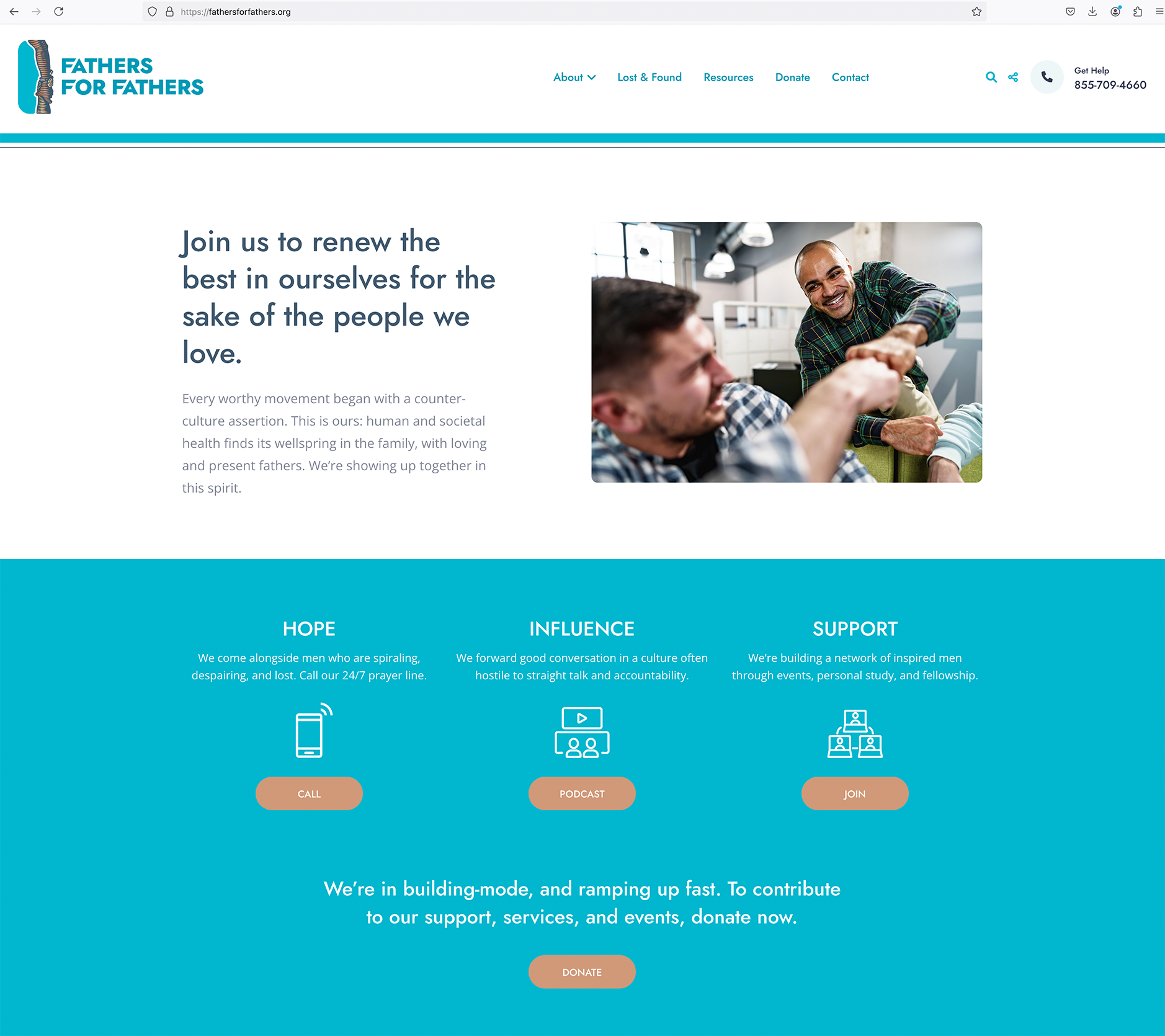

Here is the screenshot using the SSL at https:// – you can see slider dissapears:
http://fathersforfathers.org/images/Screenshot2.png
