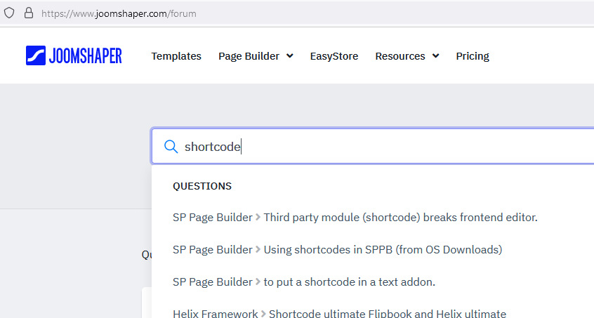

Yes, on forum many times I shared "hack" how to solve it using extra addon, find my topic & use it.
