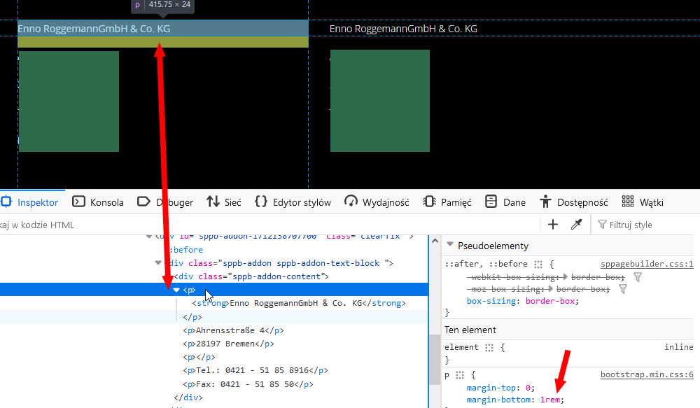

Unfortunately, I'm currently having the issue that I can't format text blocks properly. When I try to insert a blank line between the lines, it doesn't work. The default line spacing is also way too large? See the picture. What should I do?

Soft enter - a colloquial term for the transition to a new line in editors, where pressing the Enter key starts a new paragraph. It is entered by pressing usually the key combination Shift+Enter. Both TinyMCE and JCE should have it.

Hi Mike,
look & think and you will understand fast :)
It's better to switch to System editor and use <br> instead of default <p> that has margin-bottom. Clear?
