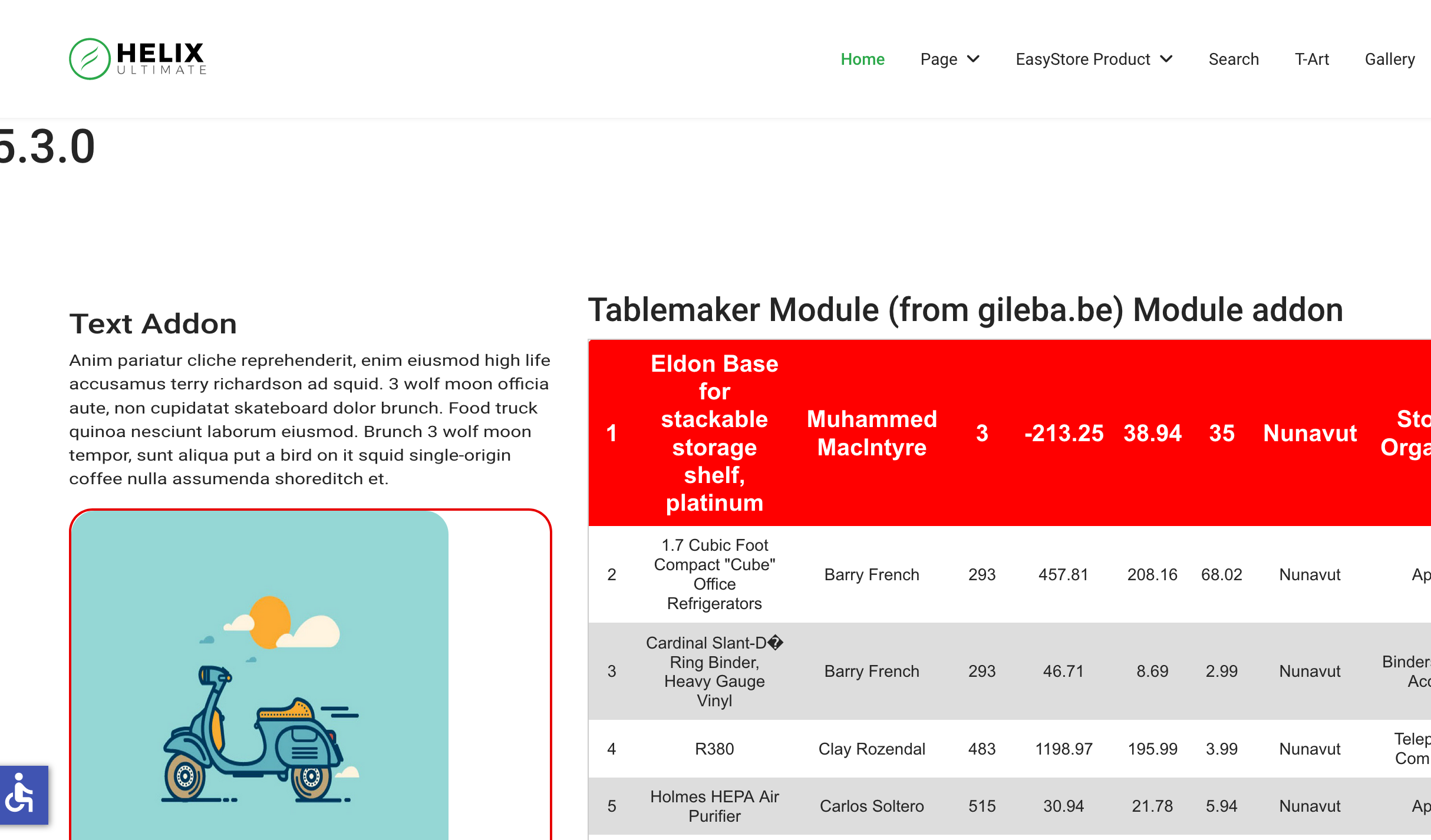

I made extra test using demo .csv file and module seems to be working fine inside Module addon. Evidence below (J5.3+SPPB 5.3+Helix Ultimate+PHP 8.2) Screenshot 2024-04-18 at 11-23-12 Home.png
It means that you made mistake in TM module settings and module developer support is needed, not ours. I hope you agree with me after seeing those facts.

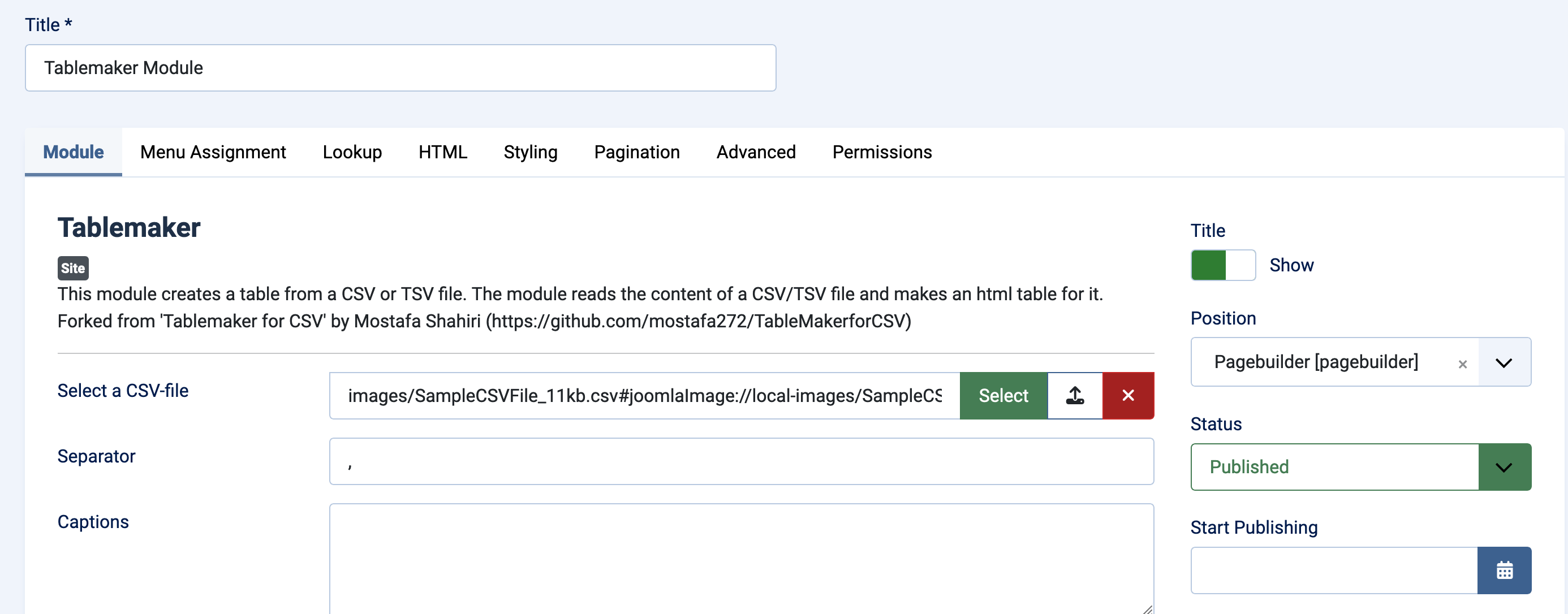

  1. Assign that module to "pagebuilder" position, and make sure is PUBLISHED.
  2. Use the back-end editor to edit Module addon and select that table module.
Screenshot from my site
Screenshot 2024-04-30 at 17-32-29 Modules mod_tablemaker - joomla 5.1 - Administration.png
