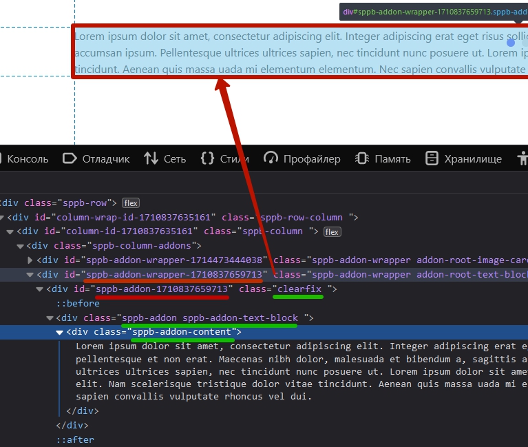

Hi. In this field, you can only use Addon ID's child selectors. To determine them, use your browser Dev Tools.
An example with a Text Addon. The selectors marked with red should not be used in this field.
