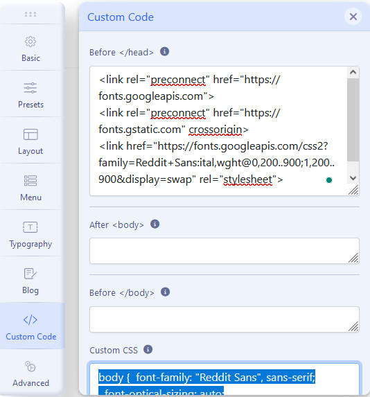

Indeed that font is not on the list yet. In that case you have to add it manually in a few basic steps:
  1. Go to: https://fonts.google.com/specimen/Reddit+Sans?query=Reddit+Sans
  2. Click "Get Font" button (blue)
  3. Click "Get Embed Code" button
  4. In Helix Template Options > Custom Code (tab):
  • In area "Before < / head>" paste code from Google Font section "Embed code in the <head> of your html"
  • In area "Custom CSS" paste
body, p, h1, h2, h3, h4, h5, h6, li, a, span
{  font-family: "Reddit Sans", sans-serif;
  font-optical-sizing: auto;
 font-weight: <weight>;
  font-style: normal;
strong, b  {font-family: "Reddit Sans", sans-serif;  font-weight: 700;}
If you want to use on whole site use above CSS, or select one HTML tag only.
  1. Save Helix settings.
  2. Remember to disable Typography tabs (!) in Template Options.

Many thanks for the great tips and tricks.
The solution works perfectly.
