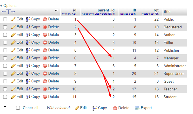

You need to change the parent_id column value. I am sharing an example with you. In the screenshot, parent of MANAGER is PUBLIC and parent of TEACHER and STUDENT is REGISTERED.

I think I may have discovered (at least a part of) the problem. I looked into phpMyAdmin, in user groups, the Administrator should have Manager as a parent. It is Public!
But I don't know how to change it inside phpMyAdmin. I cannot change it in the Joomla interface because the menu bar is missing.
