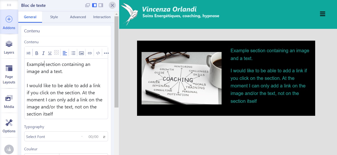

Something like this :
I'm also using css to create a zoom in effect on the section, so having a link on the text box and on the image (which is what I currently do) is counter-intuitive to the user.

at the moment, I can add a link to the image and to the text elements, but :
1/ That means adding 2 different links which is prone to errors (or more if I need several text blocks).
2/ That means some parts of the block are not clickable which makes it counter-intuitive to the user.
When coding myself, I could add wrap an href around the div element so that it appears as one clickable block to the user. unfortunately, I cannot do this using SP PageBuilder.

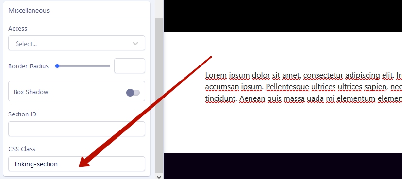

Hi Stephane.
Add class to the section
Add Raw HTML Addon with link and class
Use CSS
.linking-section * {

How do you then handle a situation like the one in my screenshot above ? To the user, it looks more intuitive to me to be able to click on the whole block than having to click on either the picture or the text.

If I add the html raw section with the link somewhere in my article, then add the "full-section-link" as as css class to the row, it completely breaks my design.
Hi.
It seems you were not attentive. This class should be added to the link but not to the row. To the row (section) you should add linking-section class. Look at the screenshot in my previous post.
You can use this class not only in the section but also in the column, in the inner row, in the Div addon.
