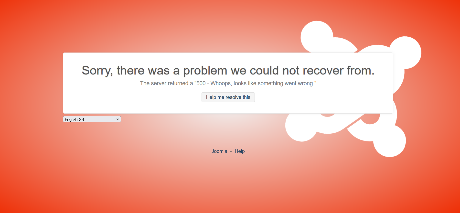

I am unable to user SP Page Builder 5 on my Joomla 5 Installation
Can you provide me guidance on how I should proceed to fix it.
Below some screenshot!
Error Screenshot

I tried to check everything. I needed to increase few value but still the same issue.
With error reporting on here is the message I have
There is no "template.atum.ltr" asset of a "preset" type in the registry.
NG-STARs Asked this
I found what is happening and I would like to have help to fix it
This is related to the fact that I am using another template administrator different from the Joomla default one. It will be helpful to anyone doing the same.
The template I am using is Xiroadmin Administrator Template
Looks like SP Page builder is having issue with it.
Here is the issue
..../libraries/src/WebAsset/WebAssetRegistry.php:135
