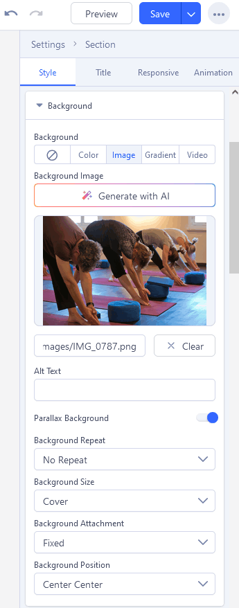

About which section you are talking about ? On yoga site there are 5 sections with background image.
Four of them (below) uses simple BG CSS rules
background-attachment: fixed;
  background-size: cover;
That you set in Section settings , example how it can be done:
But do not use .png files, use .jpg instead.

But for iPhone users try to not use "cover" otherwise Safari Mobile browser may goes crazy ....
gwd gmbh Asked this
tks a lot. do u hav an idea how this could be realized for ios and ipados?
Instead of fixed - use scroll value in Background Attachment.
Or by using Custom CSS force it only on mobile view.
