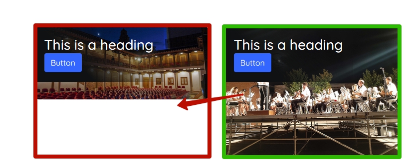

I have constructed a structure in SP Page Builder that imitates a card, applying a .card-container class with height: 300px, and a child element .card-body with height: 100%. However, I have noticed that height: 100% on .card-body does not work as expected due to several intermediate layers that SP Page Builder automatically generates above .card-body.
My question is whether there is any recommended way to control these intermediate layers without having to apply additional CSS from the site’s global settings. So far, I have been unable to access these layers from within the SP Page Builder addon settings, which complicates the intended design.

Hi.
I suppose your question is outside the support of JoomShaper.
Before applying CSS, create the correct and optimal structure. I would use Feature Box addon, instead of the complex structure that you created.
Everything else is done only through CSS. There are no options in the interface for this task.
Additional recommendation. Use images as a background (Addon's Style Tab).
Before use, create images close to real size and with the same proportions.
Now your images are not the same in proportions.
And they have several orders of magnitude larger than necessary, which will lead to slow speed of the site.

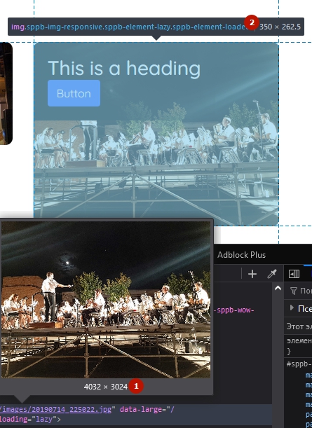

  1. Real size of existing image
  2. Real needed size
Create images with a width of 700px to have a quality reserve for all devices screens. Always compress the finished images before loading to the site.
