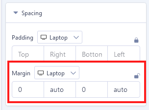

Hello, yes, the solution with the margin setting is working.
Not all items have the ability to center like a picture - for example a video ... so the margin solution is OK.

You can set margin:0 auto for that object, so far it always worked for all addons.

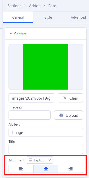

I am not sure if you noticed, but Image addon has that setting. So only one click is needed.
