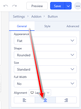

Hi Amar,
in general, there is option to center Button addon, just scroll settings below "Button Style".
Of course using Custom CSS, you can add the same center effect.
If we talk about button with label "Button >"
#sppb-addon-wrapper-ba6abc6f-29db-4990-878f-5198b6bcdee7 {
  text-align: center;
  margin-bottom: 15px;
But addon settings in most cases works just fine.
