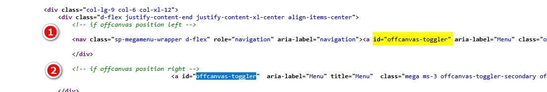

[id] attributes for active, focusable elements are not unique - for this code:
<a id="offcanvas-toggler" aria-label="Menu" class="offcanvas-toggler-right d-flex d-lg-none" href="#">

Marco, If I may ask:
  • What template name do you have, raw Helix Ultimate or Template based on it?
  • Do you have enabled Search module/field also in Mobile Menu ?
I think I know what is wrong with 2nd issue, look @Toufiq
I think there should be rule "IF" with "ELSE" and only one displayed in HTML code.

so probably 1st issue if becuase of that, I mean that same search module is used twice, you see it only ones, but Accessibility tool scan HTML code and see 2x and the same ID name etc.
In normal "Blind" Person test it will be OK (Pass), but Tool is just a Tool.

About 1st "Search", I am not sure if we can help, Joomla loads module code twice, becuase of your choice. ALternative way would be to - disable Search input field from Mobile Menu, and put only Search link to Search component view. Then only one ID will be in HTML code. For users, it will be only one click more to make research.
About 2nd "Offanvas" - small php customization is needed.
