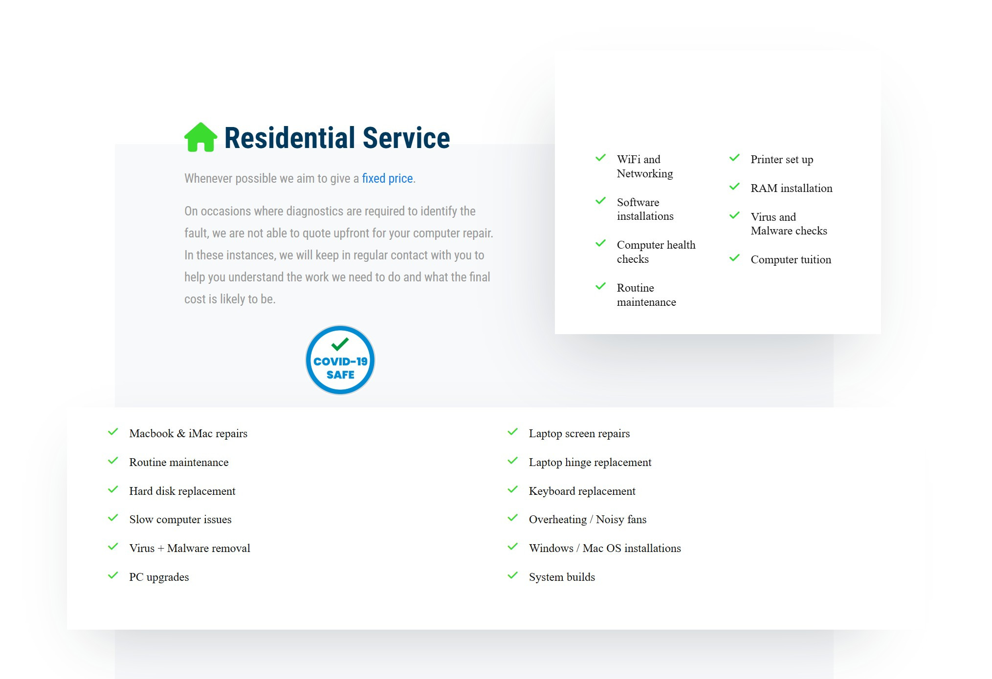

Inthe global font settings I have set Body/H1/H2/H3 etc all to Roboto font type. This has applied to much of the website but withing buttons and certain components and sections it seems to just be defaulting to Nunito Sans.
Can this be changed globally as a lot of work to apply it to every section of text manually and then repeat whenever it needs changing. I do not recall this issue in the past?
Here are some sections on various pages where it seems to default to Nunito despite all sections in menu shown set to Roboto:

Hello Toufig,
The section you mentioned i manally assigned the Roboto font earlier to it as it wasnt picking up ir displaying Roboto from the global settings.
Please see attached screen shots there are many sections on different webpages without a font specifically assigned to them but not picking up global and just have nunito sans in font selection field??
one example of the incorrect font is shown in image below that is to the right hand side of the green ticks:

Previously, Nunito Sans and some other fonts were selected, which is why Roboto didn't work. After removing those fonts, it started working fine.
You need to select one of the fonts first, then remove it. After that, your template fonts should work correctly.
