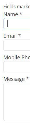

Your contact form looks totally OK (screenshot, cropped ) info_3355_2025.jpg
If do the job, should be OK. Of course in the future you can consider using different Form & reCaptcha.
