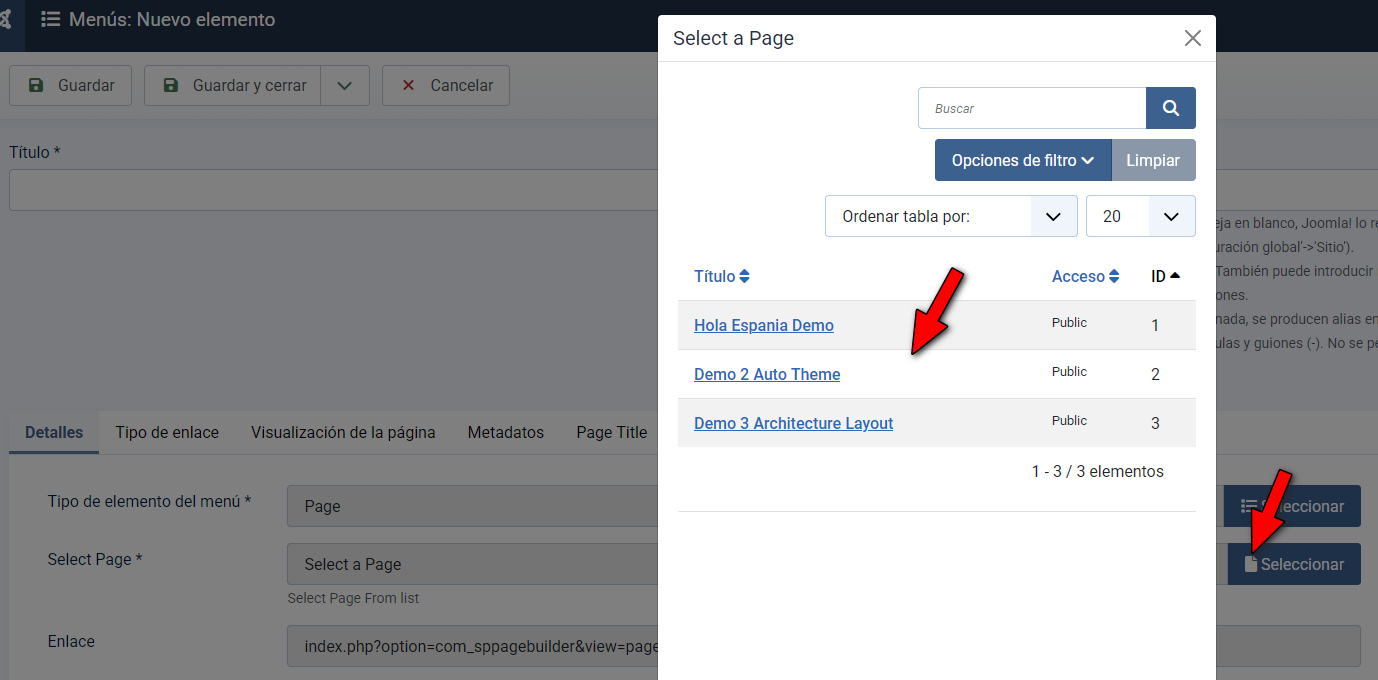

Hello, I see you've created a page, but how can I make it visible on the web if I can't activate the template?

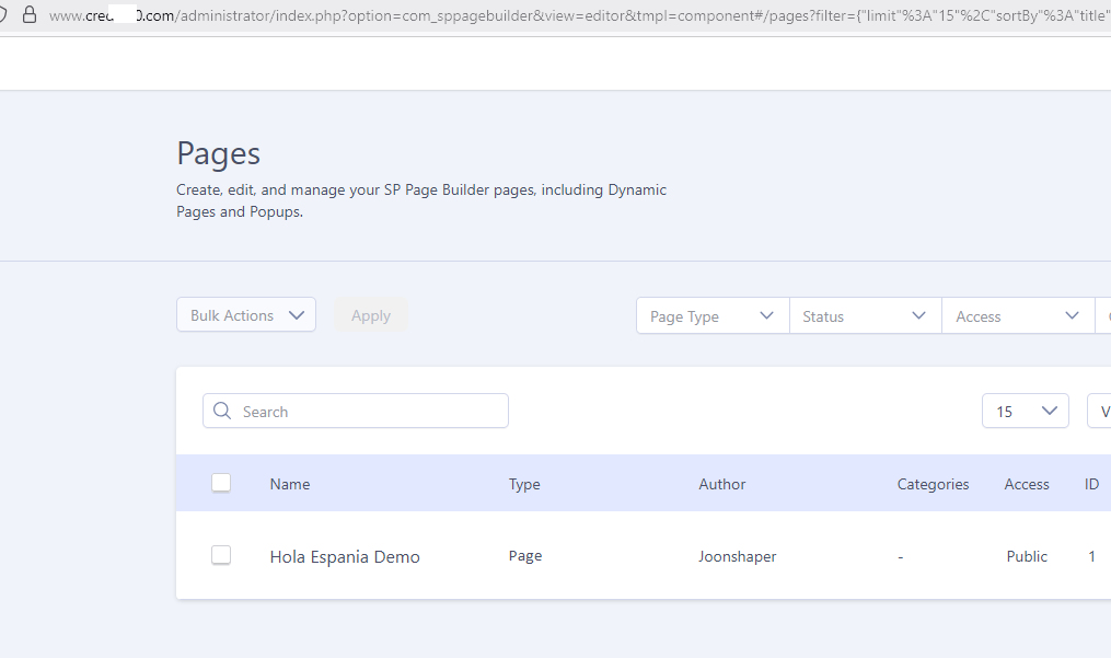

All seems to be working fine, I made test, a new page with 3 addons, and two pages with imported layouts.
What kind of technical problem you had? Or maybe if was the problem of emptiness, lack of demo pages. If yes, in most components it's like that, the webmaster has to add new content by themselves.

Yes. 3 pages, to show you that is possible, and to test if that works.

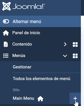

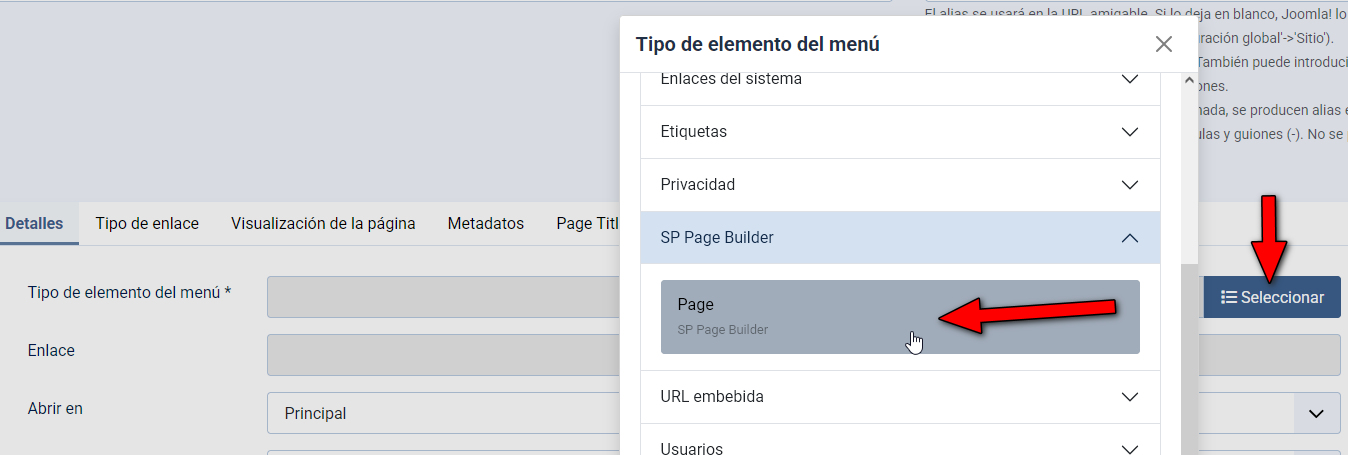

This is the same way as in any other component. You have to add to the menu page by page. I assume that you're a Joomla beginner. And Joomla looks "scary". But if you used WordPress before, it also has Menu Manager.

I gave you first basics steps that you have to learn to be able to add created pages(SPPB) to menu.

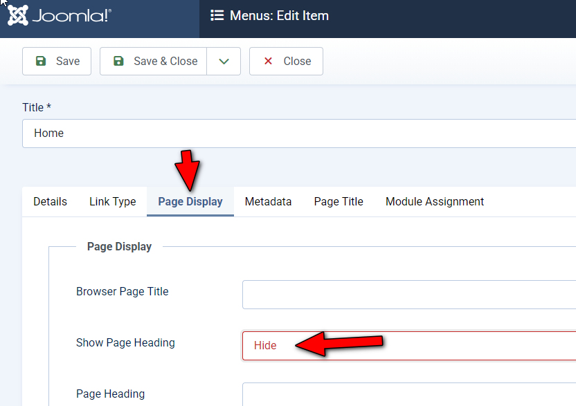

OK, thank you, I'm starting to remember. One last question, and then I'll leave you alone. When I create a page and link it to the home menu, the page title appears. How can I remove that so that the page name doesn't appear on the home page?
I already disabled. For other pages do that, in Menu item settings.
