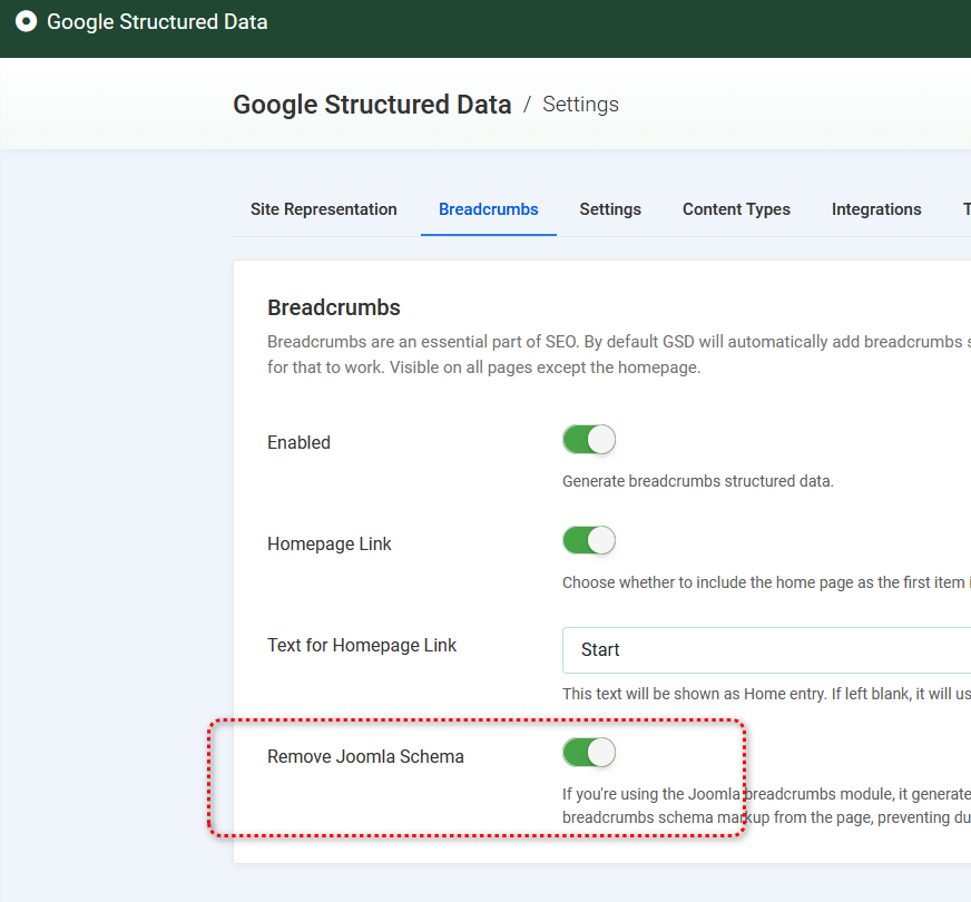

Senior Staff 3 months ago #224764
If I may....
Try that setting.
And if that will not help, ask Tassos support if we can add extra code that can clean Helix code. But in our template we only made override, so enabling that should help.
A
Addington
3 months ago #224765
I tried it yesterday and it doesn't remove your structured data. Tassos might think its worth doing though so i will ask him - thanks for the suggestion.
