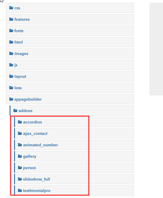

I have my website 90% built and was adding testimonials to the homepage with the Testimonial Pro addon (already in place with the quickstart install). As soon as I added a photo for the person (correctly sized to 104 x 104) the whole website crashed and showed a "0 Object of class stdClass could not be converted to string" error.
By going into the Pagebuilder Pages section I was able to disable the addon. The front end of the website came back but I was no longer able to edit the homepage using the frontpage editor.
I went back into the Pages section and deleted the addon and now I can edit the homepage using the frontpage editor again. However, every time I go back to the frontpage editor and try to add the Testimonial Pro addon, the site crashes now.

I deleted addon override from template folder. It was created few years ago, that's why it was problem with new SPPB. Now should be OK - becuase Joomla load that addon directly from component folder, please test.
In case of similar problems with those addons, just detele folder or files inside TEMPLATE FOLDER!!!
Using template based on Helix3 is not the perfect choice. Consider template based on Helix Ultimate if this site should be valid for longer period of time.
