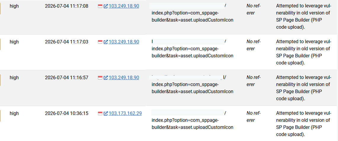

Senior Staff 1 month ago #228257
My screenshot is from RSFirewall (commercial). As you saw they are trying (blind attack) but they cannot do anything. Those are bots, not humans!
Free component ( https://htprotect.org/en/ ) it should protect your site (J3-J6) as well.
