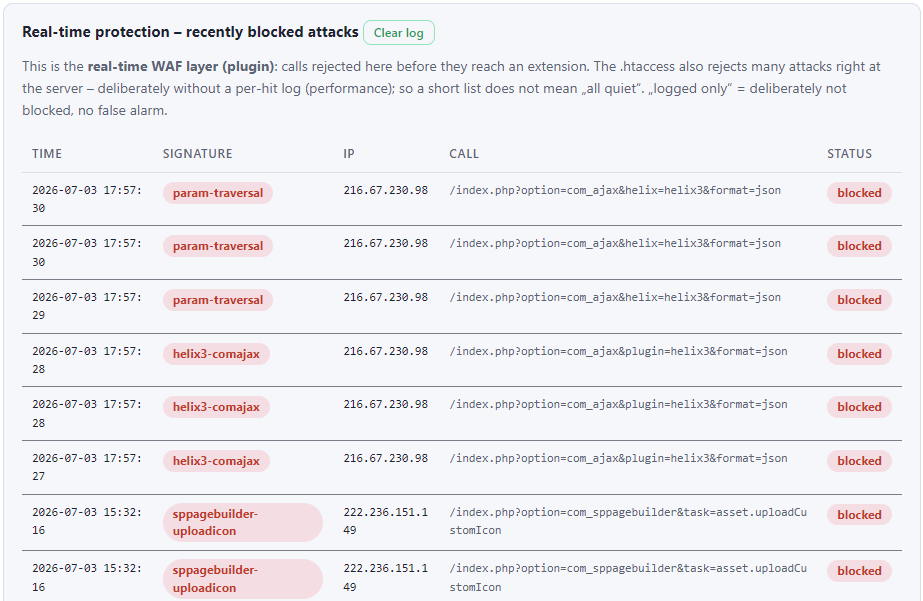

Do you also use Helix3? There was another vulnerability.
And did you clean up all bad Super Users?

Eyk Markstein
https://htprotect.org/en/helix3
Was it a defacement - the second hack? The HTProtect extension should detect that if the Helix3 Template Options have som malicious JavaScript included.
And it blocks those attacks.
